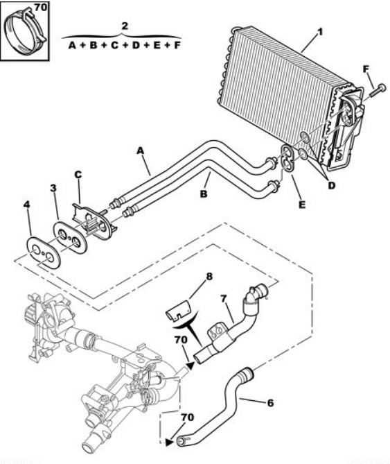

This is the heater Matrix on a C5 1.8 Petrol for example - it's similar to, but much smaller than your engine radiator, item (1):
These can become blocked over the years, resulting in reduced performance.
The pipes Chris is talking about are at 'A' & 'B'.

Yes I know these are the pipes, they are the one I described in the TS. They are both hot, one very much so and the other a tiny bit less.
I would therefore firstly need to focus on everything else that might be the culprit.
