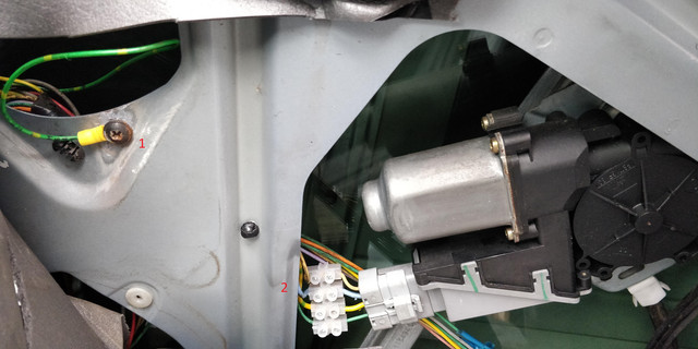

Hi,
When I purchased the car the window didn't work, and an auto-electrician added the earth as labeled 1 on the photo below.
I have added power (directly from the battery to the two pins (beige and green) location 2 that registered 14V when I checked the switch - nothing happens.
Should the motor make a noise if the wire has snapped?
I have watched a few videos on Youtube and the window always up when worked on, is it possible to raise the glass another way?
Thanks.
Thanks.
