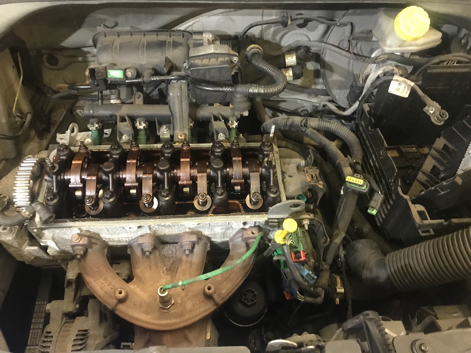

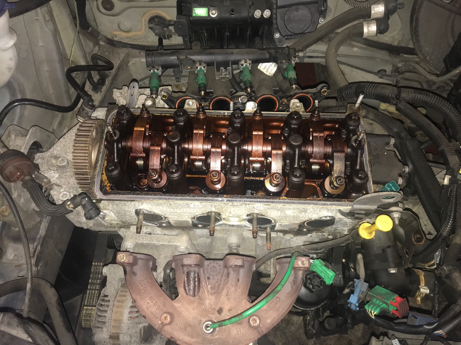

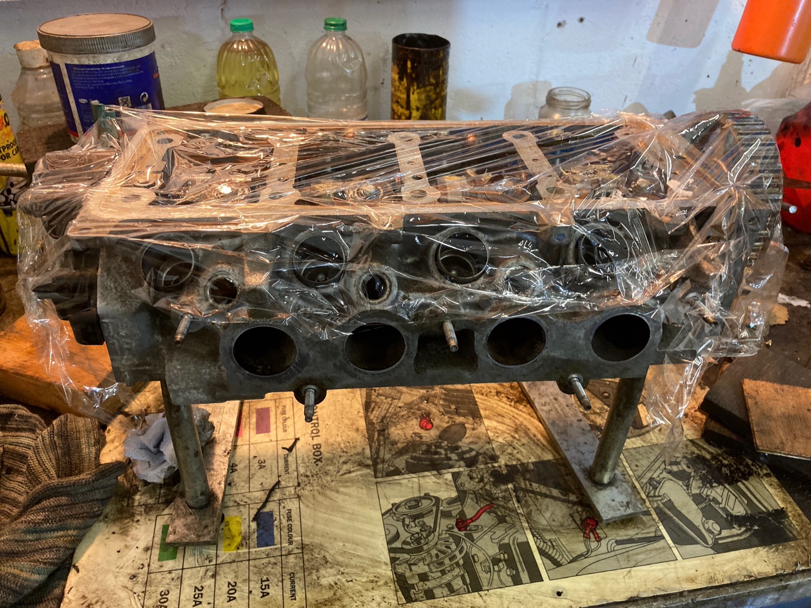

Bought this car with a stripped timing belt.

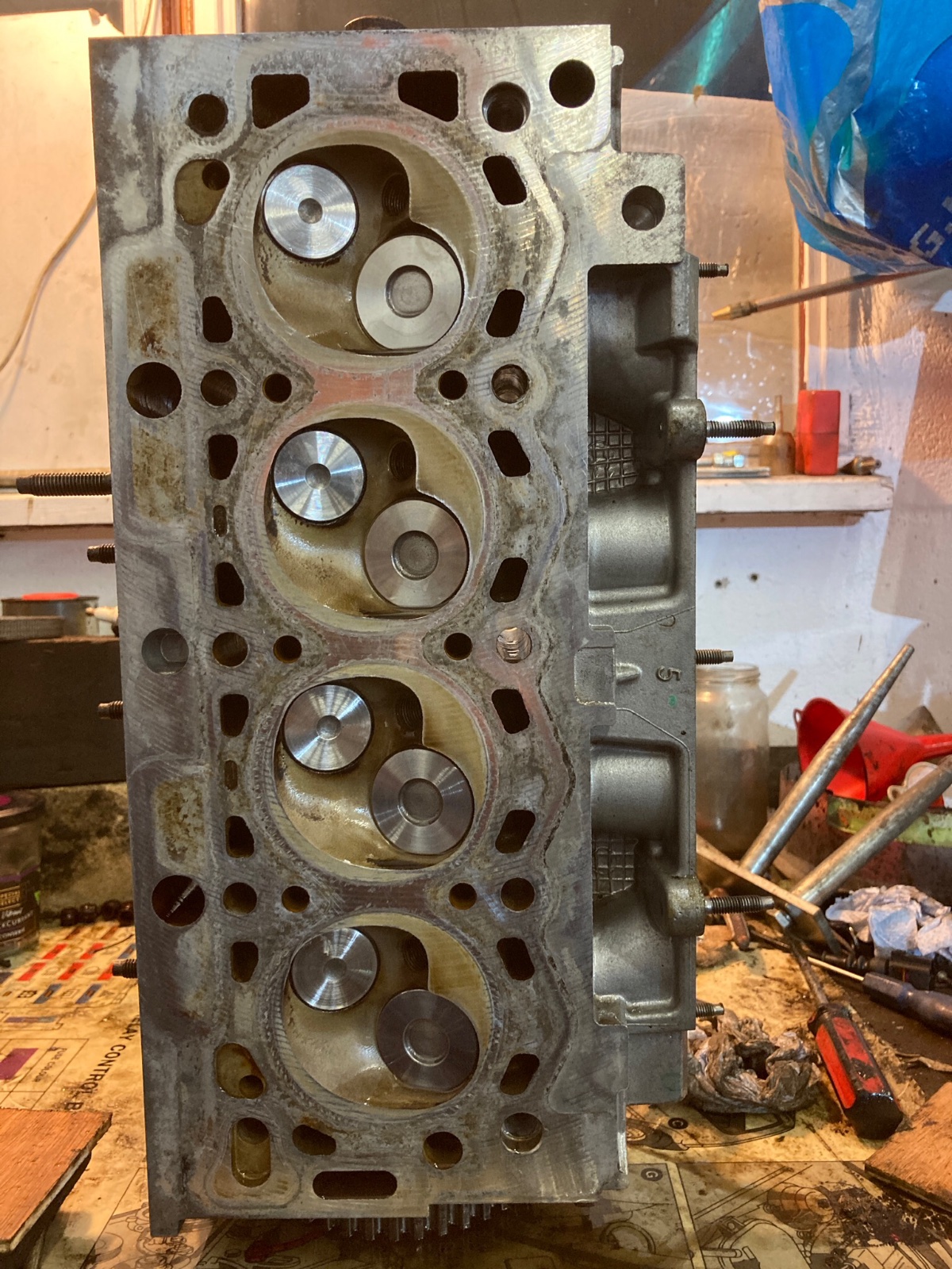

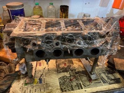

Renewed 8 valves, seals etc.
Head back on.

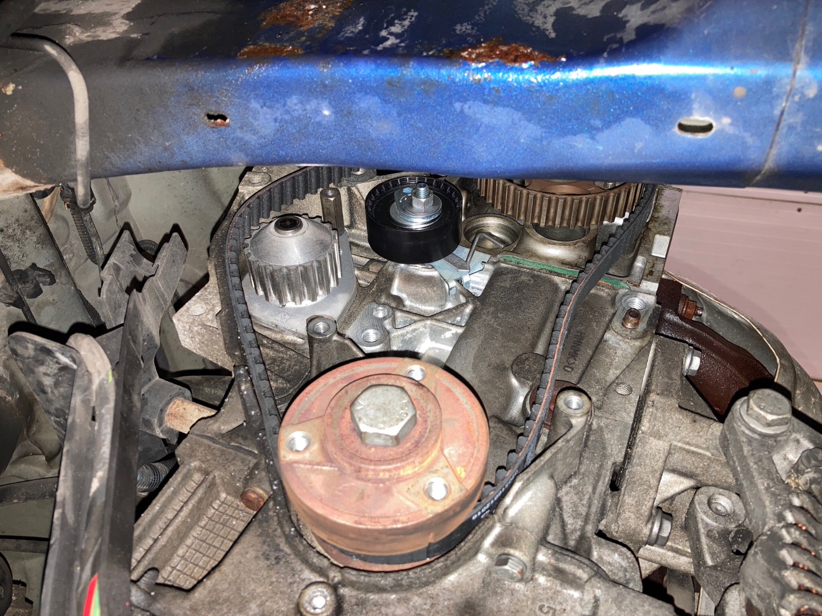

Ready now to put the timing belt etc. on.
Seems improbable to get my squiggly timing pin in the back of the flywheel as there is the oil filter mount assembly there.

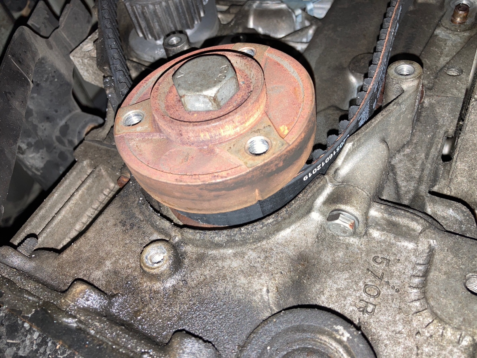

On the crank pulley mounting flange there is a decent, factory cut, mark that will be a tdc mark, I’m assuming this should point downwards and line up with the small nib cast into the oil pump housing.
Can anyone confirm this?
As the piston to cam timing was not correct when I bought this little beauty I had no opportunity to make my own marks.
Any help greatly appreciated.

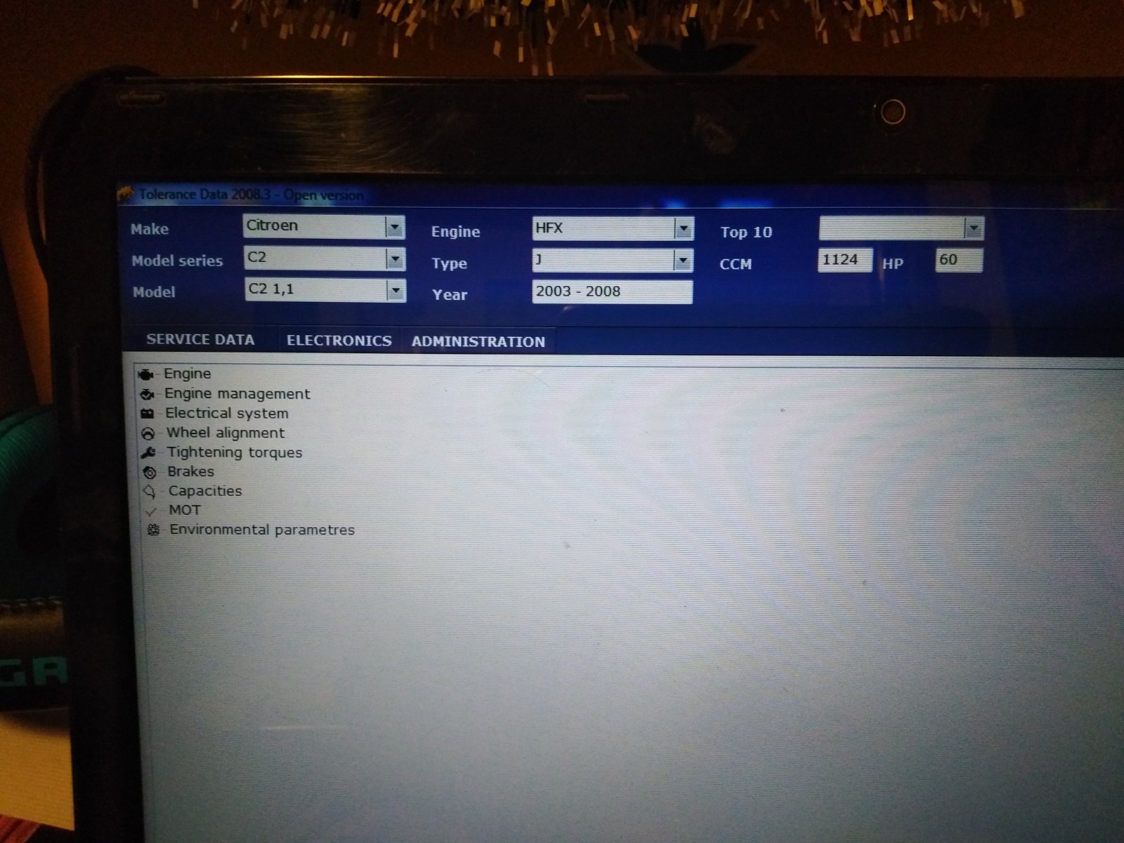

Thanks for your replies, I already have this information.

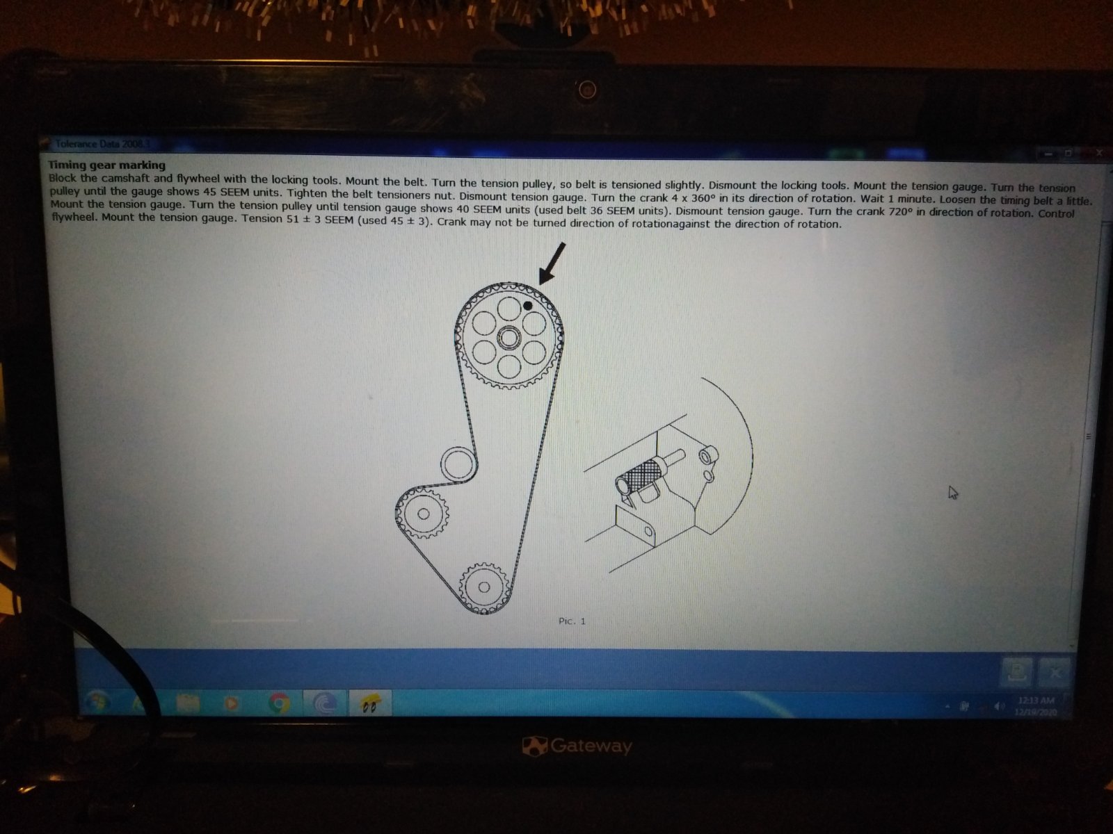

(How did you get the screen shots onto the forum, I can’t find how to do this.)

You go to the full editor, upload the pictures and send. You can find the dtc through the spark plug hole, but some motors are not brought into phase that way, but the pistons are flat in the middle of the path, the other thing is that maybe the lock on the flywheel is needed to tighten the pulley that tightens in Nm.

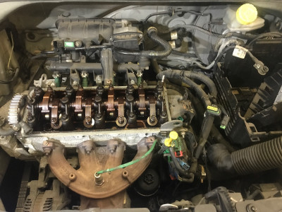

Good point about the pistons level in the bore on some engines; the “K Series” Rover engines are set this way.

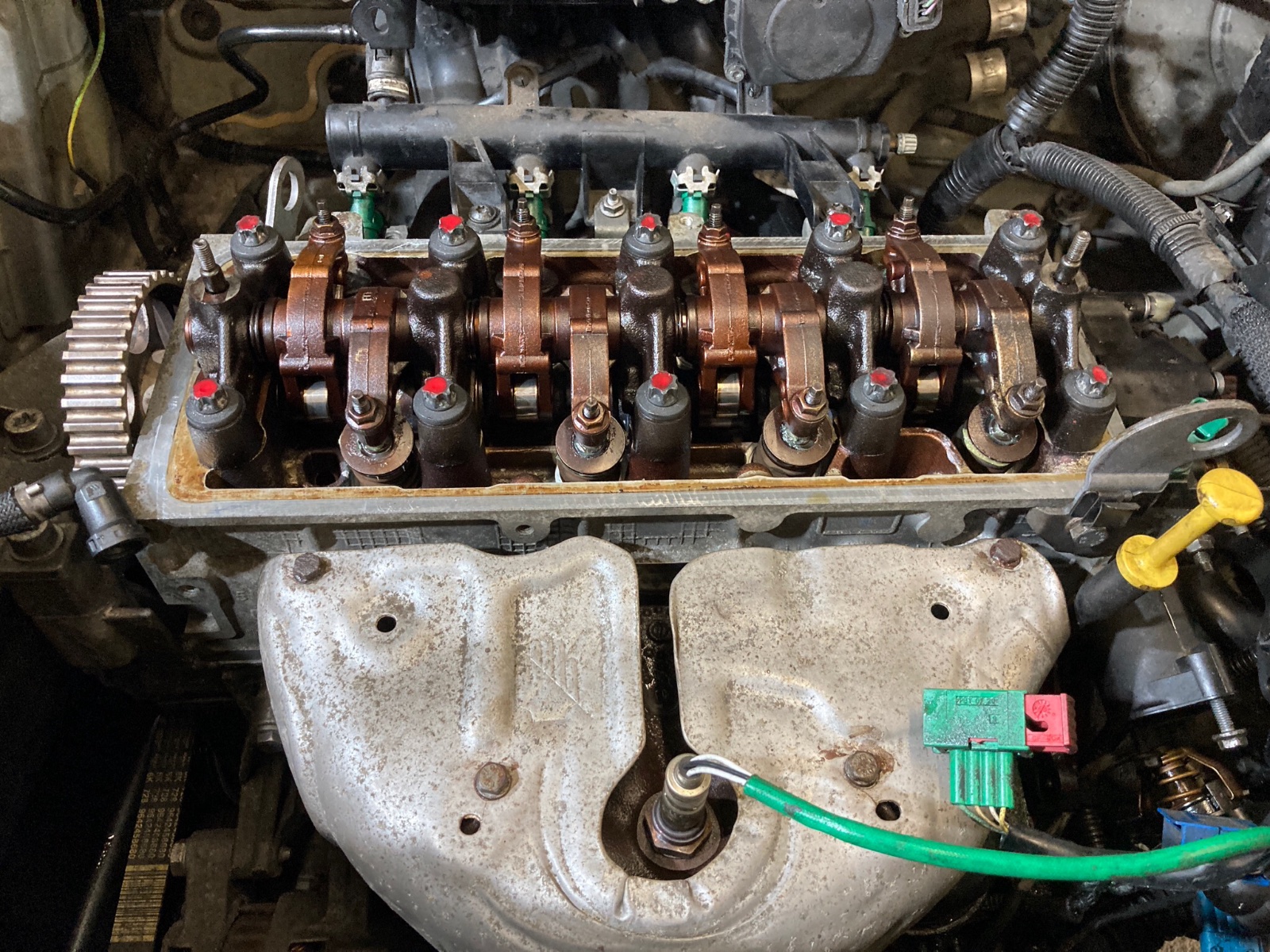

On the TU engine the rocker arms, when the timing pin is aligned at the cam-pulley/head, are on the base circle of the cam, meaning that cylinders one and four should be at TDC when setting.
I’ll have a “jiggle” with a bolt and long-nose pliers as mentioned but failing that I’ll go for the “plug hole plunger” method.

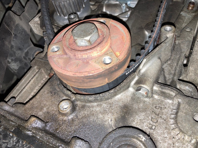

The tensioner pulley set up is a pain but stick with it, else you will end up with another busted timing belt or the belt may skip teeth. When you are finished turn the engine over by hand a number of times and check that the belt is running on the center of the camshaft sprocket. Incorrectly manufactured tensioners will cause the belt to wander off the sprocket.

Attained tdc on no.1 cylinder via the plunger method, confirmed this with borescope at the block webbing hole to the flywheel, marked the factory cut on the front pulley flange mount to oil pump housing with blob of paint (which, incidentally, is nowhere near a corresponding mark; much to my chagrin), fitted belt, adjusted via Autodata, rebuilt and bingo engine runs very well. Three new bulbs. Two new wiper blades. Freed off the parking brake actuating levers on the brake shoes and I’m on the road. Top treat.

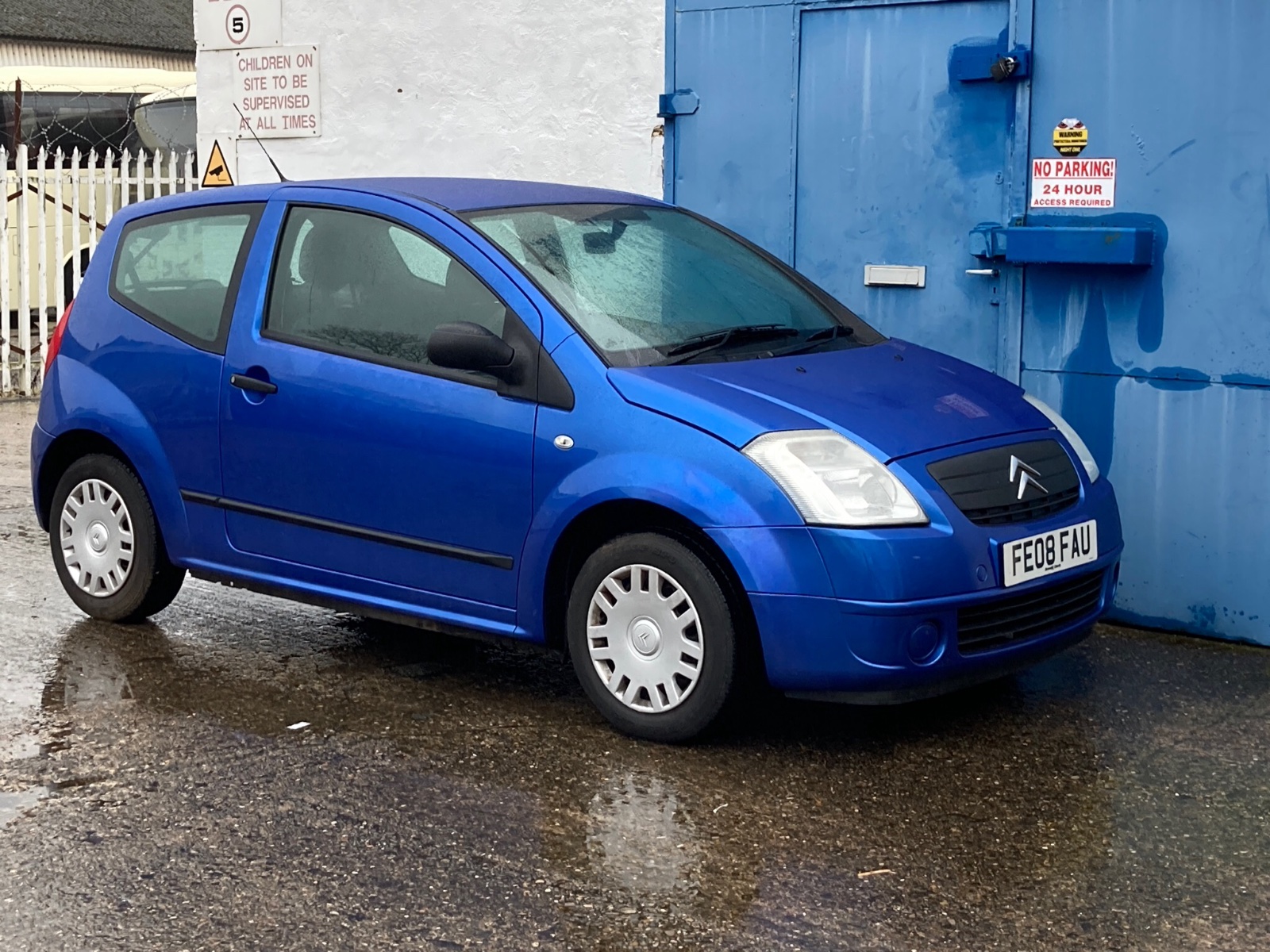

The de chevaux belongs to a friend of mine. This car took part on a road trip from the UK to the Sahara Desert, and lived to tell the tale. I MOT’d it last month. It passed the test.
