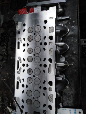

petarc1971
Posts: 61
Joined: 01 Mar 2019, 19:50
x 10
Re: Coolant loss mystery
Unread post by petarc1971 »
Cylinder head after straightening, no hydro test was done because there was no loss of coolant - removal is due to a broken glow plug.
