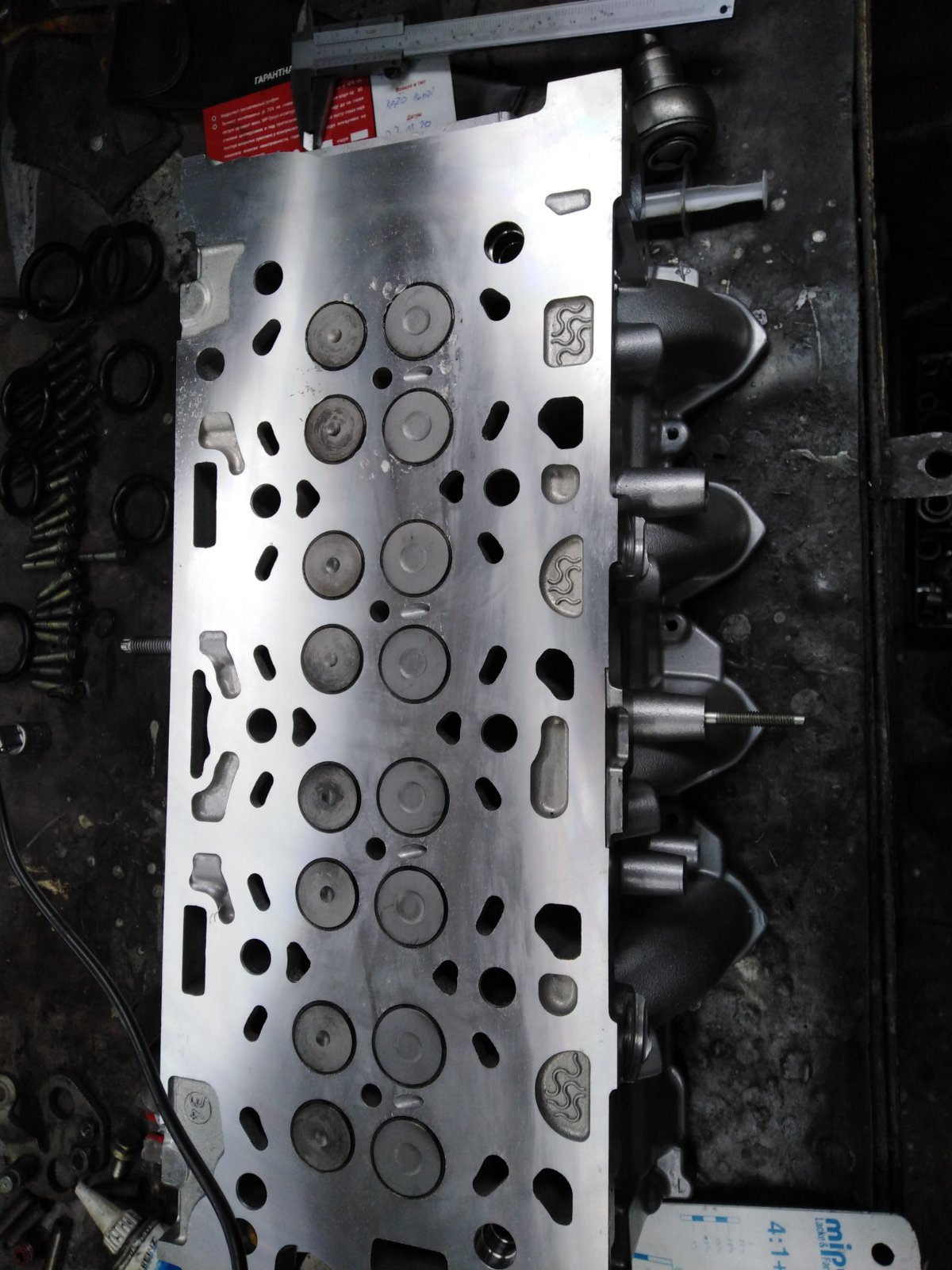

The hydro test is performed in a machine workshop after processing (straightening) the cylinder head. When I said stem I meant the part in the block where the piston enters. I'm using Google Translate so it might be confusing.
- Posts: 57
- Joined: 01 Mar 2019, 20:50
- x 9
Re: Coolant loss mystery
Cylinder head after straightening, no hydro test was done because there was no loss of coolant - removal is due to a broken glow plug.
