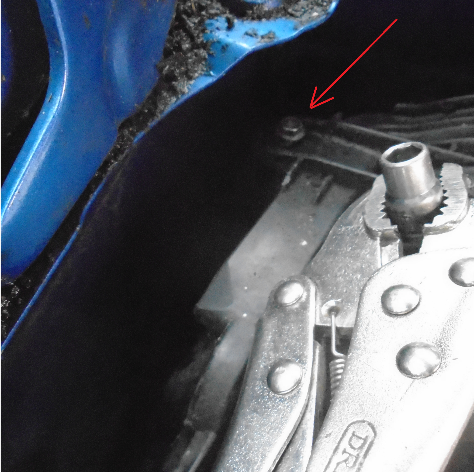

What attaches the blower motor to the rest of the heating and vent gubbins? Yes four 6mm little screws (6mm..,very funny Renault). Three are alright to get at. The fourth has been engineered to be difficult. Often you wonder why there are various protrustion and mouldings on bits of car. Well they are purposely designed so you cant get a reasonable turn on a spanner/ socket or whatever to undo fastenings.
Yes and how many of you have a 6mm offset spanner in their toolbag. Not me, but even if I had it would be too long or not have enough offset in it to avoid the unnecesary bulge.

Well I had to resort to the small molegrips and a socket, and yes it works, but its at a snails pace.

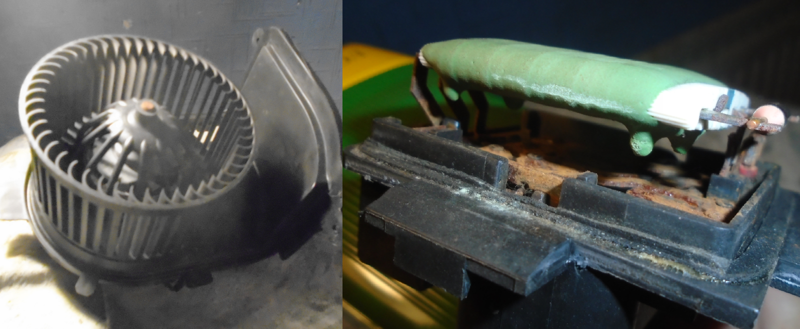

There's nothing wrong with the motor, connected it up direct with a couple of leads and it spins freely.
The resistor pack looks a bit rusty to me. Might clean up but maybe its best to get a new one. Knowing me I'll most likely try the scrapyards first.

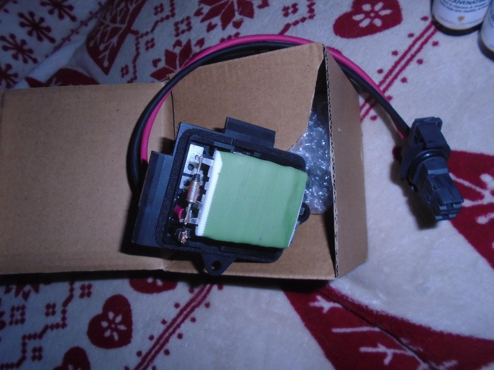

A new part is not that expensive

Ordered the new part, then thought I'll just waste some time cleaning the old one up with a file, and a bit of air intake and carburettor cleaner. Tested it out, and hey presto 1,2,3, and 4 speeds functioning again.

On the plus side the new part arrived when I got back, after only ordering it yesterday lunchtime. Good decision, clearly the efforts with the file and air intake and carburettor cleaner weren't a permanent fix.

Fitted the new part today, but not before giving the motor and its 17 tear old brushes and commutator a bit of a dowse and squirt of contact cleaner. Again as of now back to working on all 4 settiings.NewcastleFalcon wrote: 12 Dec 2020, 14:19 On the minus side.....French car electrics did what French car electrics do. Work one minute then don't the next.
