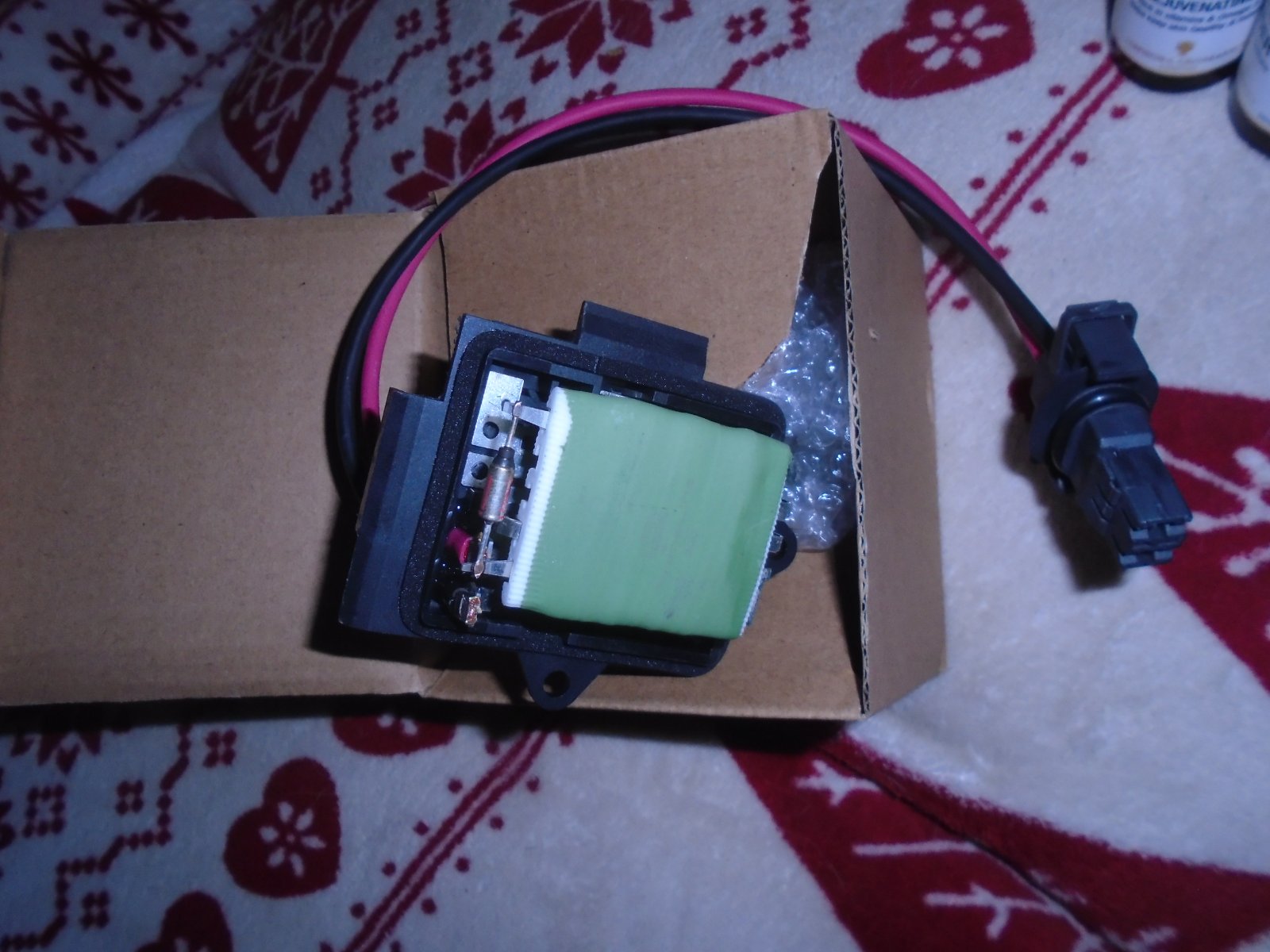

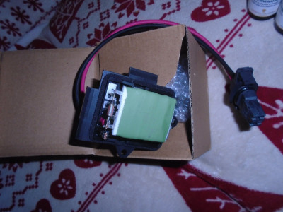

Re: Clio 2 Heater Blower
A new part is not that expensive
Ordered the new part, then thought I'll just waste some time cleaning the old one up with a file, and a bit of air intake and carburettor cleaner. Tested it out, and hey presto 1,2,3, and 4 speeds functioning again.
Put everything back in place, job done for now.
Fitted the new part today, but not before giving the motor and its 17 tear old brushes and commutator a bit of a dowse and squirt of contact cleaner. Again as of now back to working on all 4 settiings.NewcastleFalcon wrote: 12 Dec 2020, 14:19 On the minus side.....French car electrics did what French car electrics do. Work one minute then don't the next.
