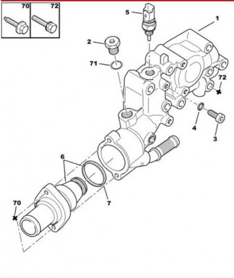

i want to know where are the temperature sensors. i think there is one which gives information to the ECU, and one to the gauge on the dashboard. can you help me locate them. if there are more, let me know as well.

They are in the thermostat housing, I would imagine a 2005 model will only have 1 sensor (green) older ones may have a separate (blue) sensor for the temp gauge on the dash.
