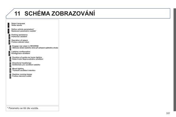

Re: Peugeot 308 - RT6 Continuously Rebooting

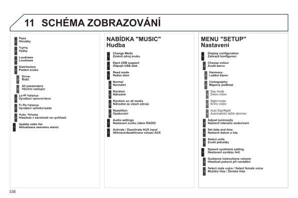

Ok, if this is Czech then see the images below. These have the Menu options in English and the Czech equivalent. You need to hit the SETUP button and navigate to the correct location shown in Section 11 on the last page. I've included them all for reference, but they are in page order. Click the image to zoom them up, sorry they aren't very clear - it's the export to JPEG from PDF.
If it wasn't Czech, send me a screenshot of the initial screen when you hit the SETUP button in case it's in Mandarin or something else

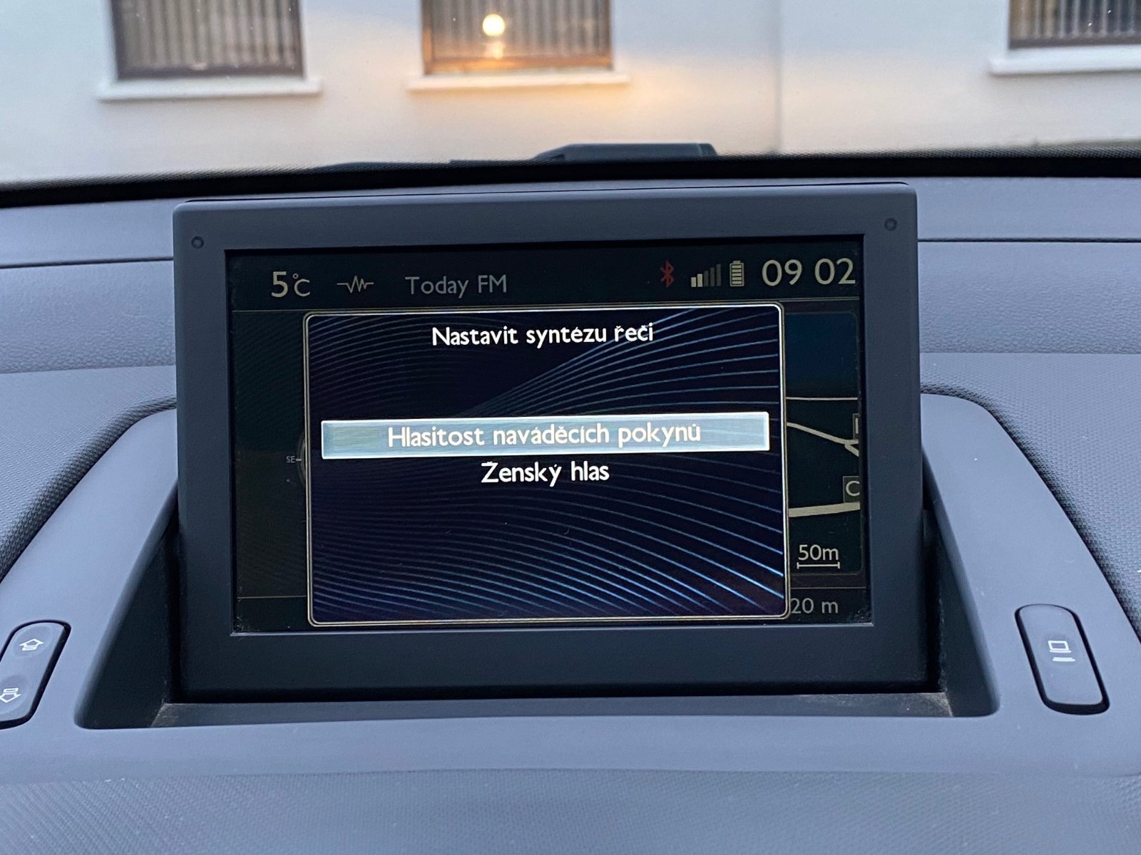

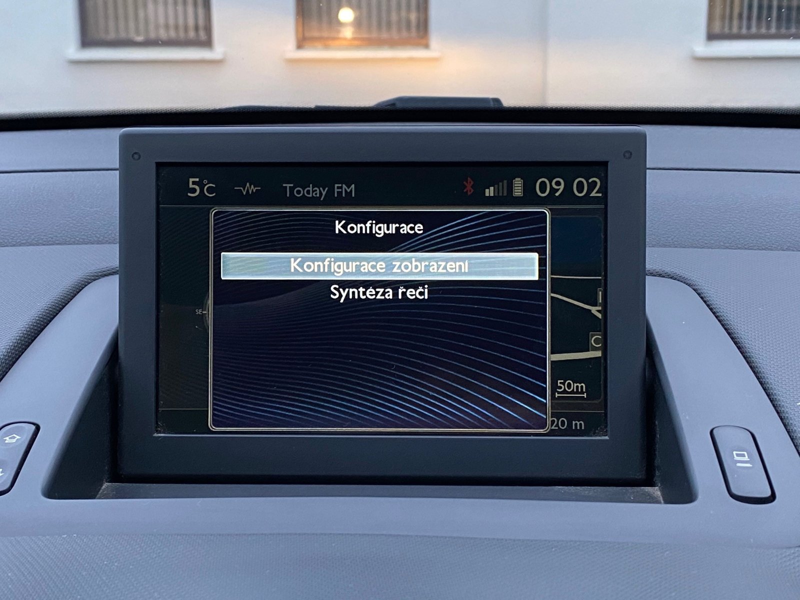

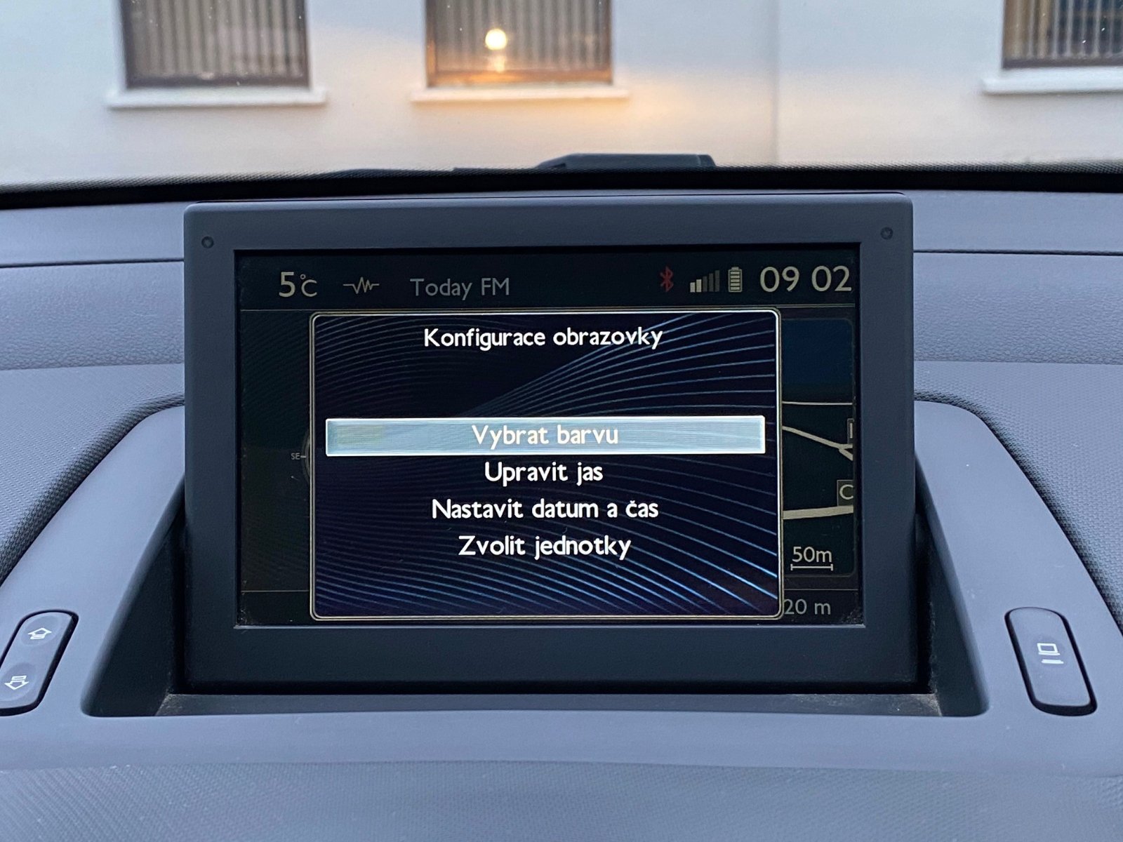

pobbrennan_2012-308
- Posts: 6
- Joined: 13 Nov 2020, 09:06
Hi Marc,

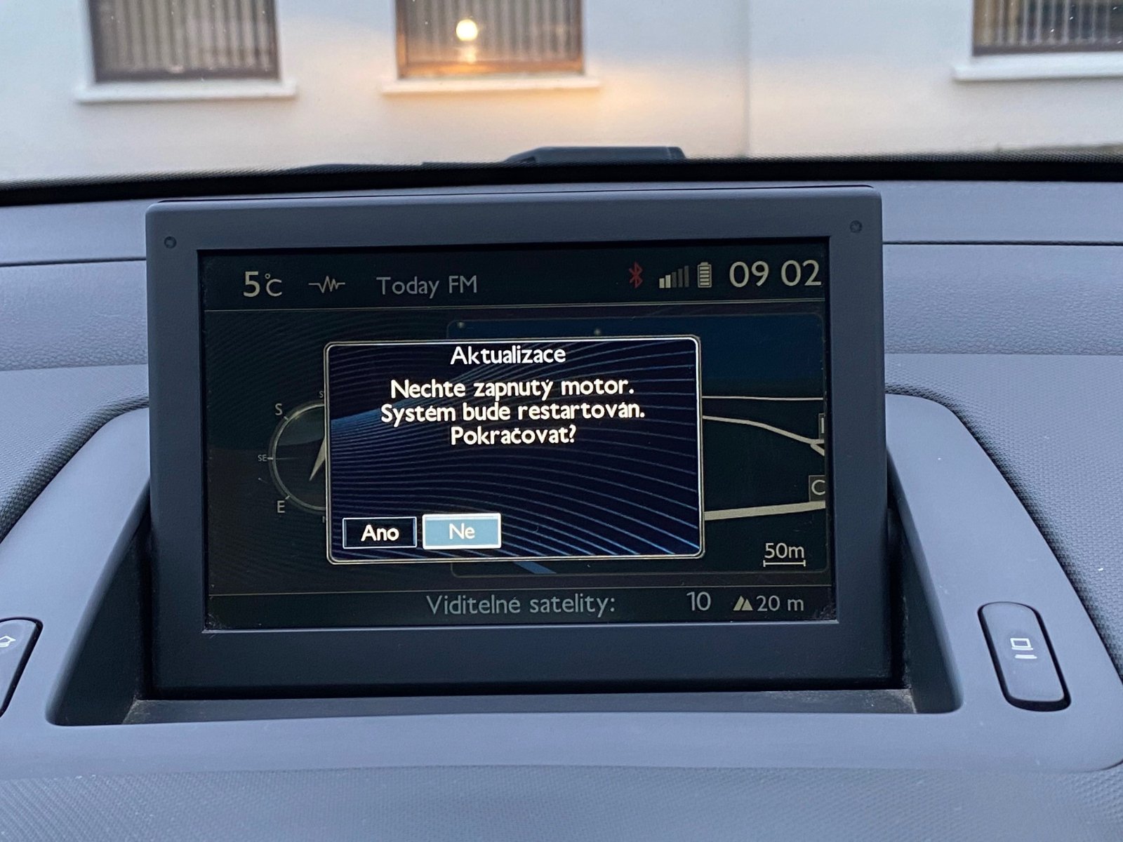

Please see images attached. Review images from the bottom up 'Car 1, Car 2, Car 3 and Car 4' in that order
Regards
Paul
| (1) | (2) |
| (3) | (4) |
Regards
Paul
Google translate agrees that it's Czech.
- x 6945
@pobbrennan_2012-308: Hi Paul - the language option from the menu is missing in this case and I suspect this is because it has retained the settings from the original RT6 unit from the country the VIN was coded in. This is one of the issues with a different unit.
The only way to get the language options back onto the configuration menu is to ask the dealer to configure the RT6 for you. This requires a software configuration from the dealer using their servers / Diagbox to change the customer language. Once they have done this and set it to English, this should allow the language menu to be activated on the RT6 itself. That's why it is currently missing.
pobbrennan_2012-308
- Posts: 6
On Image 1 when I am in the Setup menu......
1. Display Configuration - I have this option
2. Speech synthesis setting - I have this option
3. Select Language - I do not have this option
4. Define vehicle parameters - I do not have this option
- x 6945
Exactly - see my post above for the reason why.
