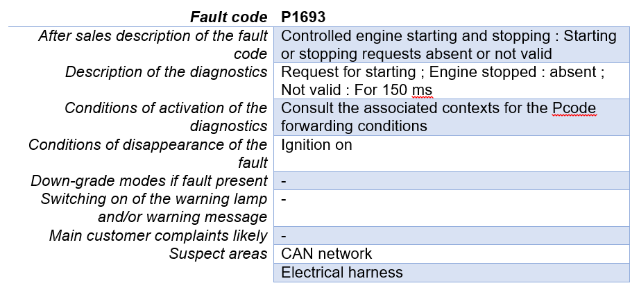

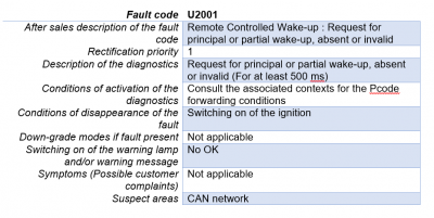

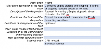

Re: Citroen c8 2007 hdi 2.0l none start

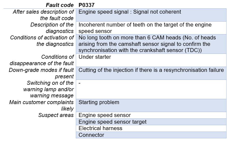

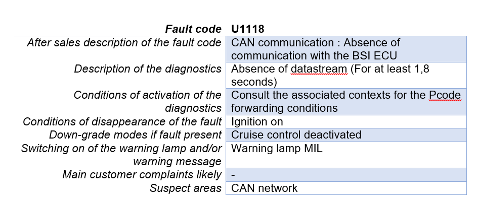

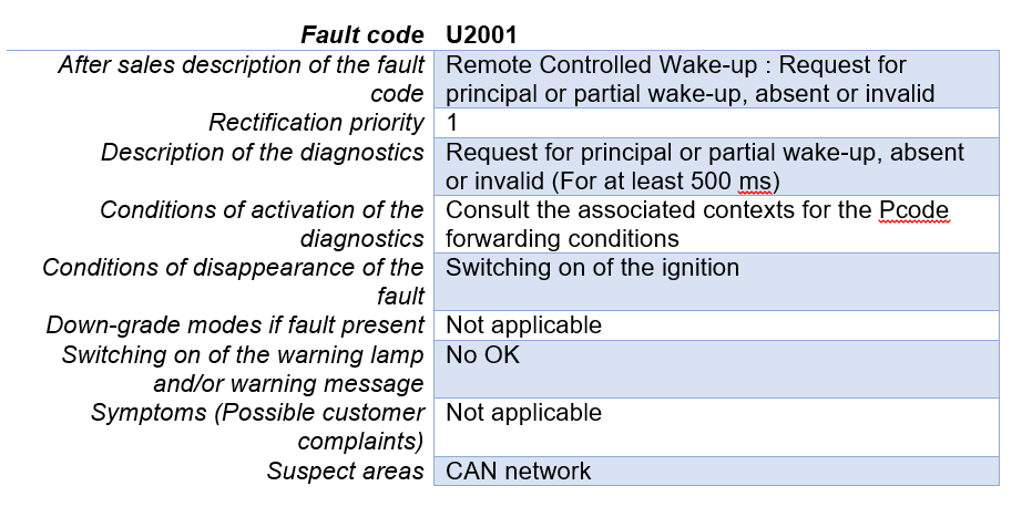

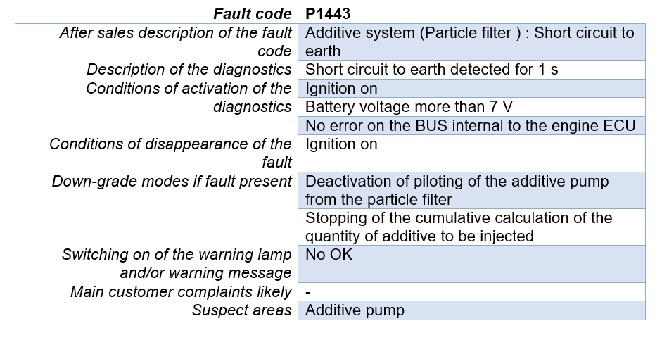

Here you go, click on the images to magnify and zoom them up to read them:
Now the P0337 fault you had previously may be an issue - the engine speed sensor as if that is sending duff info, then it will affect the injection. So although you have cleared some of those faults down - that doesn't mean they are gone and if / when the conditions arise again, the fault will come back.
