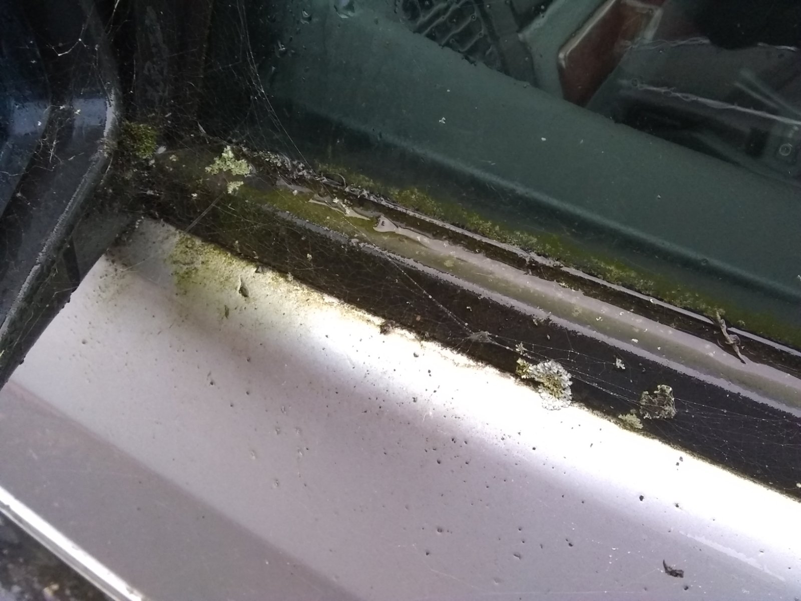

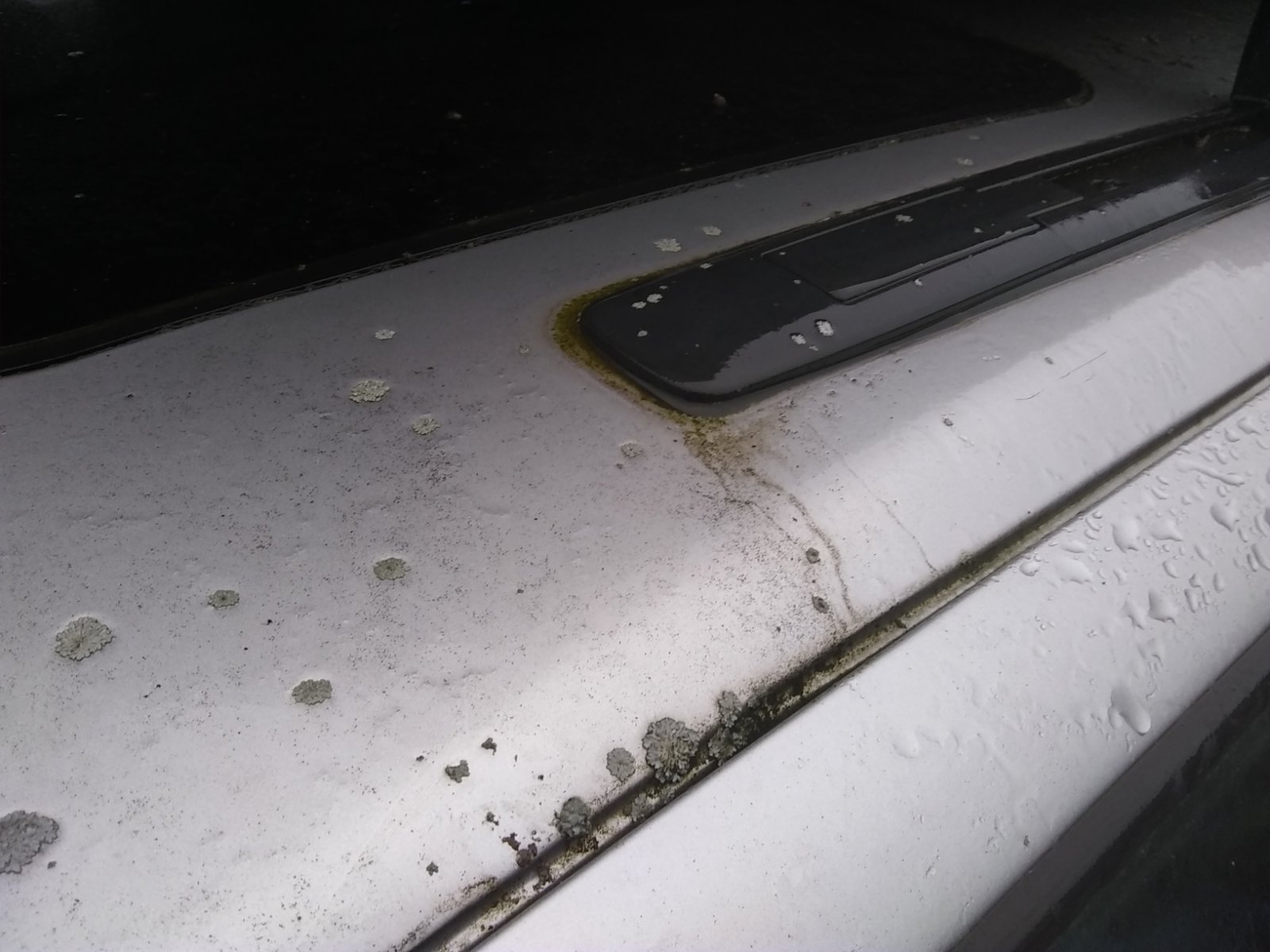

what a lovely car ! quiet , comfortable , Powerful ! im impressed, it needs a dam good clean though ! with moss all around, it needs tyres as they are sun baked cracking, and i have to fix the abs light ?? any ideas where to start on that one ?
