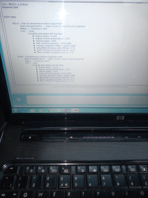

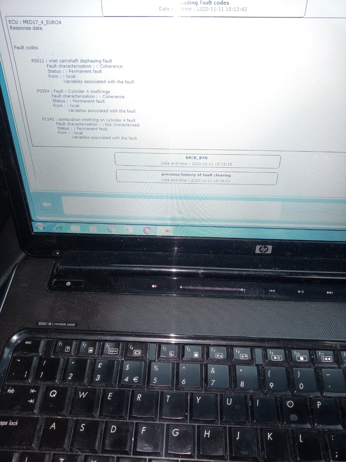

Re: C4 vts
Ok, i tried myself, but no luck, so lets ask the experts.
Antipollution fault.
When you start it rough as fk and the fist screen of faults come on, cleared and the s3cond screen of faults came, the fan for some reason starts going after 5 minutes running.i believe just when the antipollution fault comes on
For some reason , i cleared the faults yesterday and run like silk just the inlet dephaser fault on , but not very much noticeable.
Today after cleaned that solenoid and changed the oil just in case, well all came back and now
