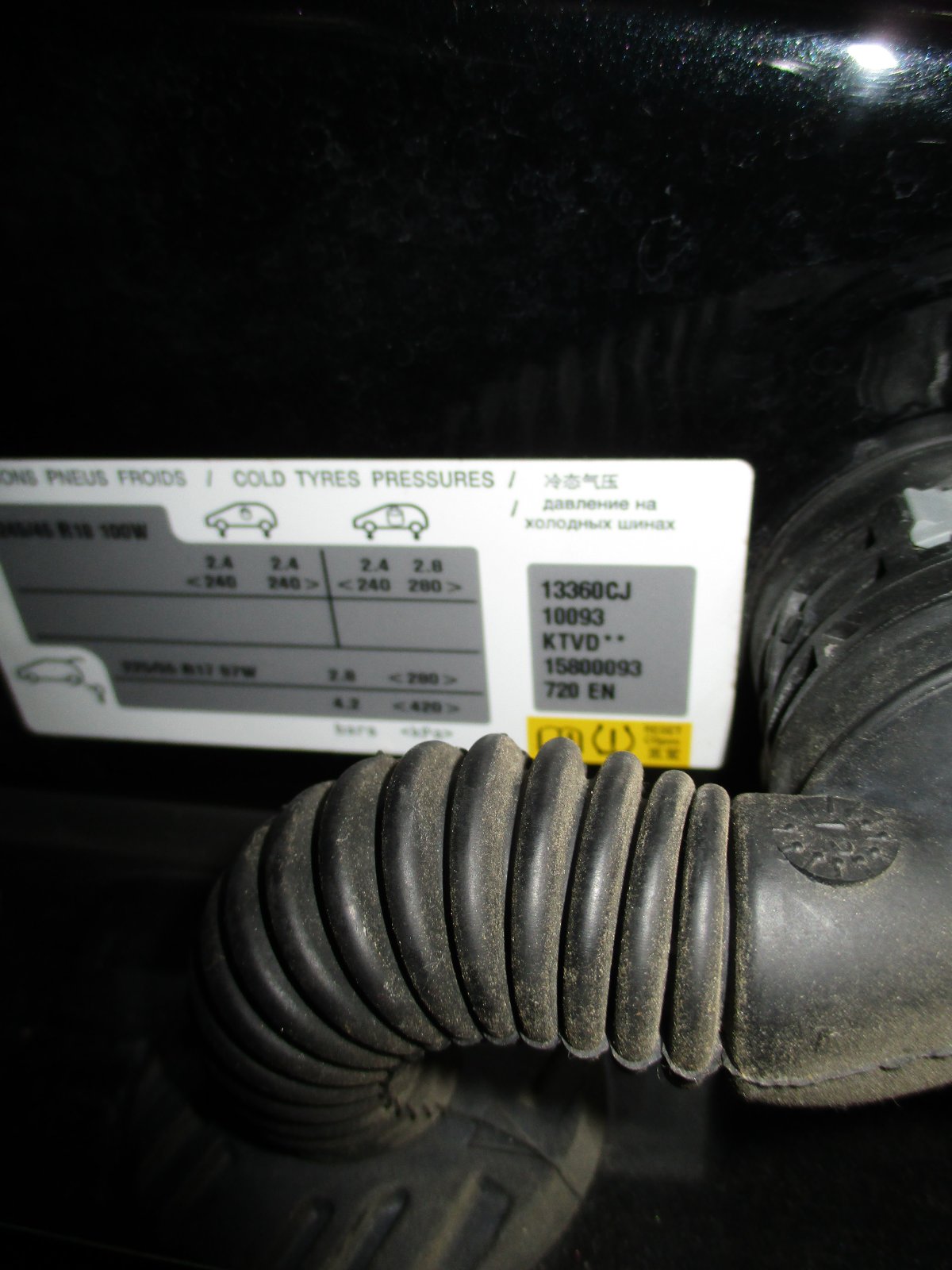

The connecters on the additive tank have green bands on
The photo is from the sticker on door pillar but not sure which numbers refer to build date etc

Ok, so although you have a 2013 model - it is still a DW10BTED4 engine (Euro 5) and despite your build date 13360 (June 10th 2013). This would normally indicate Blue connectors with Powerflex additive, but if you have the green click fit connectors, then it should take Infineum F7795.

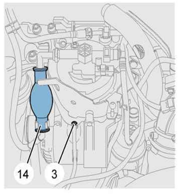

Annoyingly, because of the stupidity of the last owner, you never got the 'low additive level' warning message - which would of avoided it running out. But you will need to bleed the fuel circuit which is what you would have to do if replacing the additive tank (which is effectively the same as having it run dry). It should then try and add some additive the next time you put fuel in, so I would suggest you don't top the tank up fully - but put in 10 litres or so, then drive about for a bit, then do the same again - in order to trigger that fuel has been put in and to get the pump to inject some additive into the fuel tank. It may take a while for assisted regeneration to take place until there is sufficient additive in the fuel tank.
Just fill up the tank and then use Diagbox to reset the additive counter. You don't tell it the quantity of fluid added - you just reset the counter to zero.
- Place a draining tray under the engine.
- Open the bleed screw (3).
- Operate the priming pump (14) several times.
- Close the bleed screw (3).
