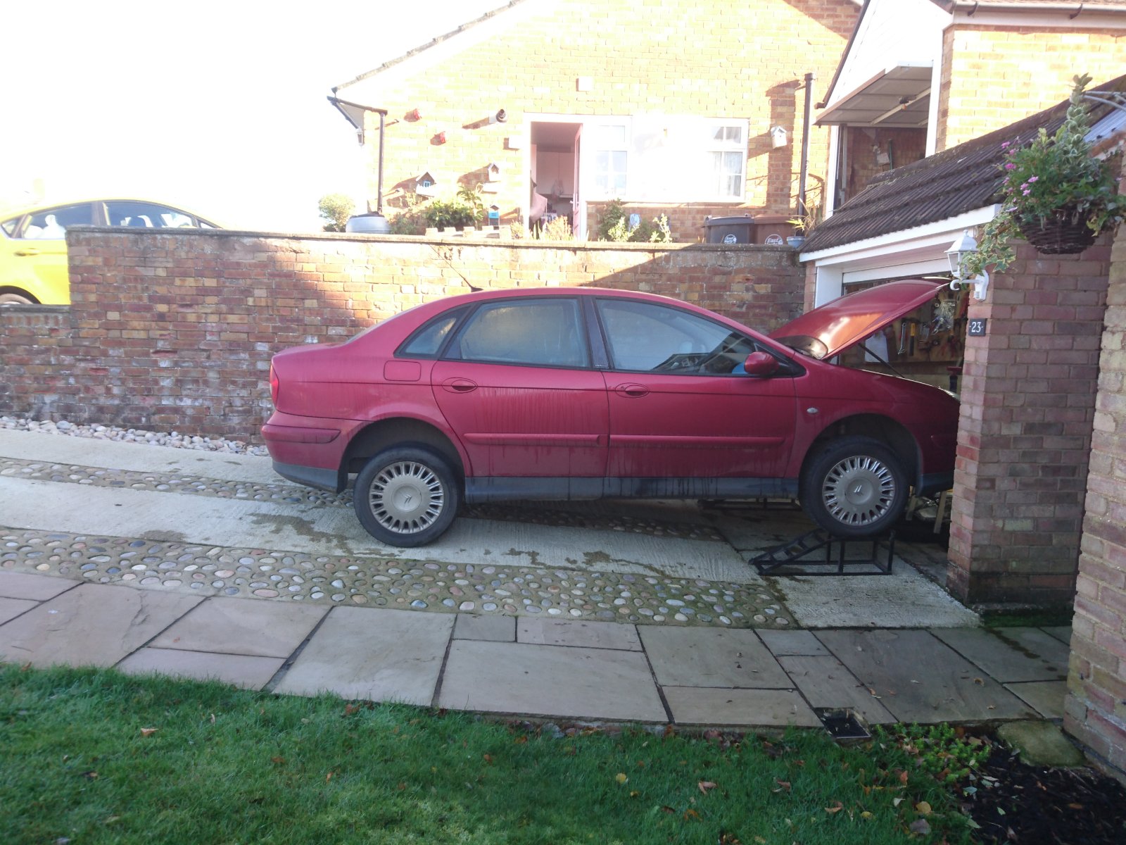

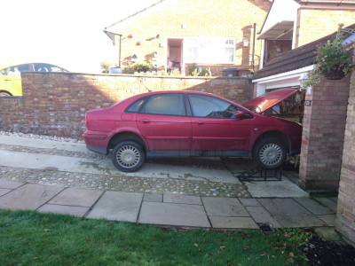

Firstly I have to put the front of the car up on the ramps to make it level for the oil removal:
Car levelled on my sloping drive

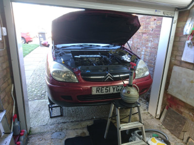

Then just pop the bonnet, remove the dipstick and insert the suction pipe making sure you get to the bottom of the sump. Then pump the vacuum and wait and watch, it takes a fair few cycles to empty the sump and much time passes. I make use of that time by checking the pads and discs and replacing the air filter, popping back for a few more pumps from time to time. I then cleaned and lubed the door hinges and tailgate catch and other checks until I heard the sucking sound from the tube telling me it was sucking air with the oil. At this point I tend to add a few more pumps and then jiggle the pipe around to make sure I have removed the vast majority of the oil.:
The suction system in place

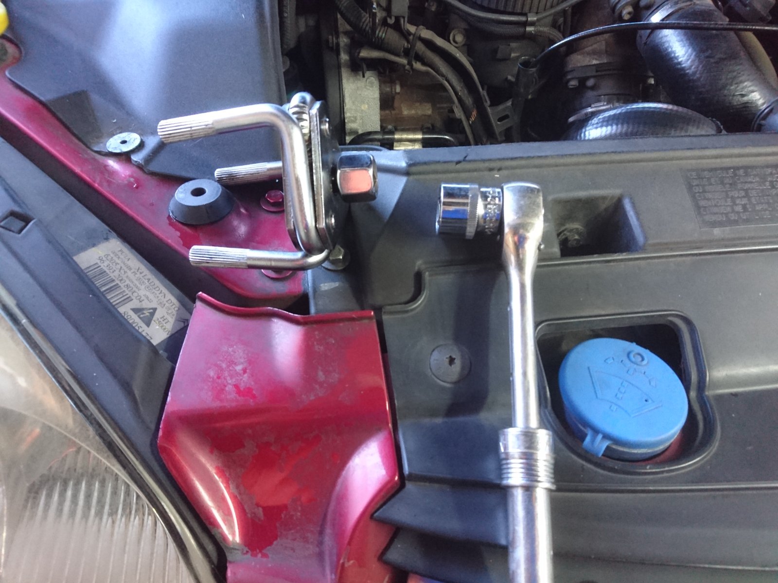

Then its time for the oil filter. I place a huge cloth, usually an old bedsheet, under the filter housing and poked into the areas below where oil may run and then use my three pronged filter removal tool to undo the filter. Fit the replacement as usual and refill with the oil I bought from James' link a few weeks ago. Start, run and stop then recheck and top up as necessary and the service is complete. I have to say the sucker takes 40-45 minutes to do the full empty and on putting the waste oil into an empty can I can confirm it removed 4.8 litres which is almost all it should have and the filter was half full which I forgot to put into that can for measurement, pouring it into the can from the Celerio's service on Monday. So I am happy enough that I have completed a 97%+ oil change and, although it does take a lot more time, I found it much easier than removing the grotty under engine cover and draining it conventionally!!

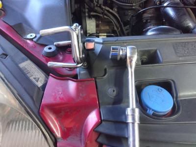

My oil filter removal tool is ideal for this car with just the right amount of space to use it!!:
Filter removal tool
Filter removal tool
