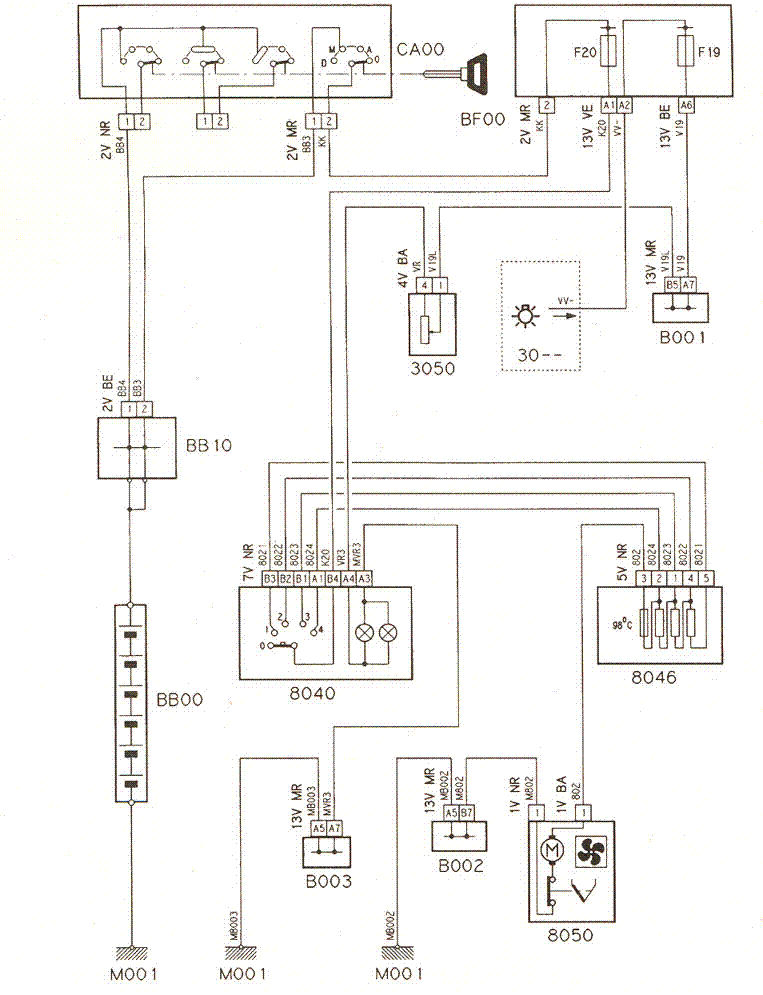

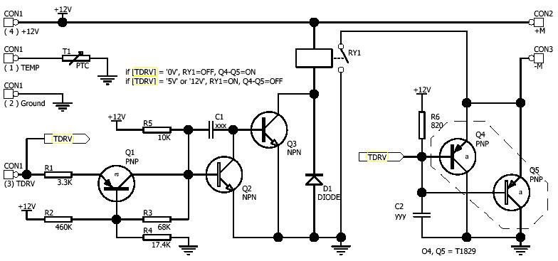

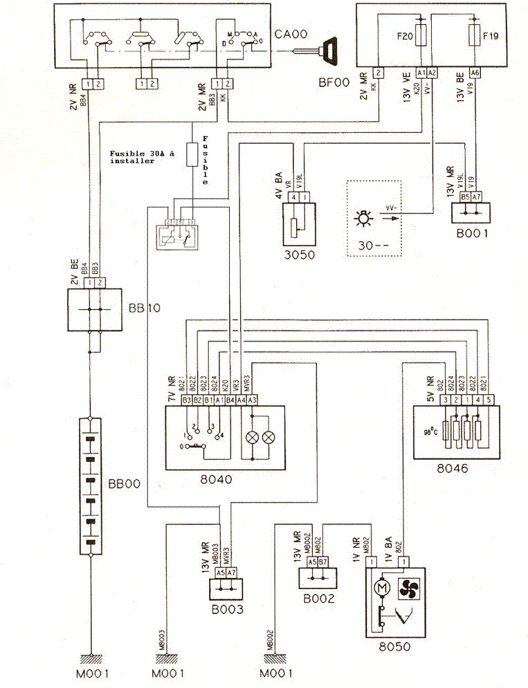

Click to enlarge.
Blower module:
Before mod:
After mod:
Blower module:
Before mod:
After mod:
