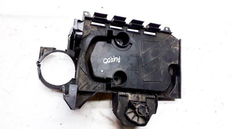

While im on. The battery clamp. I googled it and saw mention of bolted in lower clamps on the X7.
Mine however seems to have a clamp with a square drive hole?
Am I meant to use a socket extension on it or is it broken?
So as per this picture I dont have the plastic nut,just a square hole in its place
x 6945
Re: 2009 C5 depollution fault
Mine is the same. You’ll find a socket set wrench extension bar is the perfect fit to go into the whole and turn it slightly to tighten or loosen the battery clamp.
Put some silicone spray on it or grease and work it back and forth and you’ll find it a lot easier to use in future.
