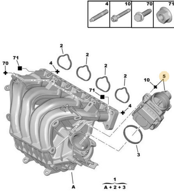

There's actually no MAF on this engine (I've removed reference to this in my earlier post),
P0170 Fuel injection: Malfunction
P0172 Mixture regulation: High stop
Not much info at all on this engine....
This is the Air Intake Throttle Valve Housing (Part: 1635X0)

Just a follow up.
Car required a reset as the new TB was struggling to idle (symptoms like an air leak in the inlet side)
As I was doing the battery it was no drama. Working fine now.
I was concerned my new battery (correct for the car) was a smaller unit than the unit I was removing.
However since fitting I havent seen economy mode on the car at all, whereas previously it was on every time I got in the car and cut radio power a couple of minutes after switching the engine off.
Hopefully a prudent move for winter.
