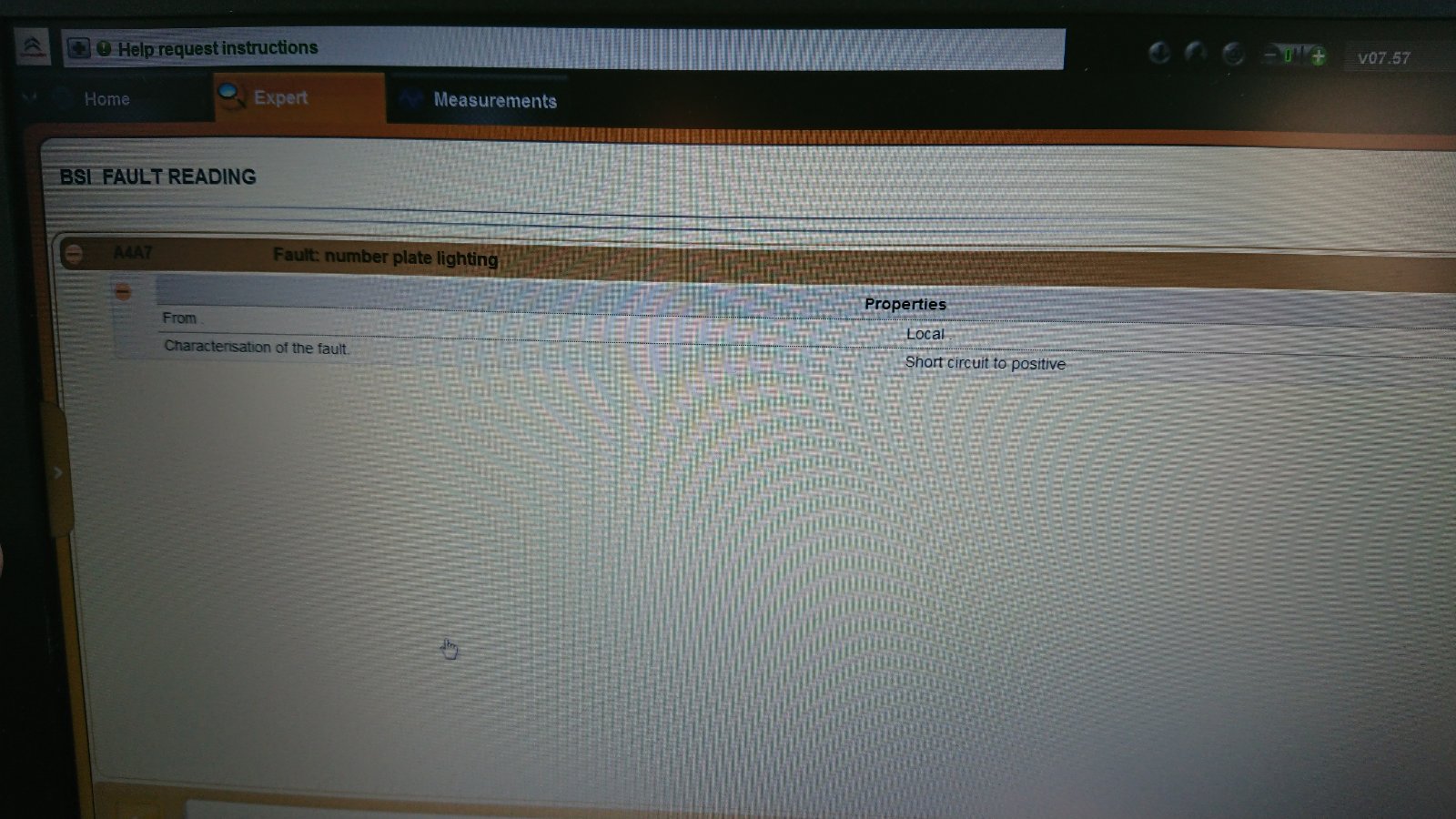

Update the sidelights have blown bulbs. Changed but still not working

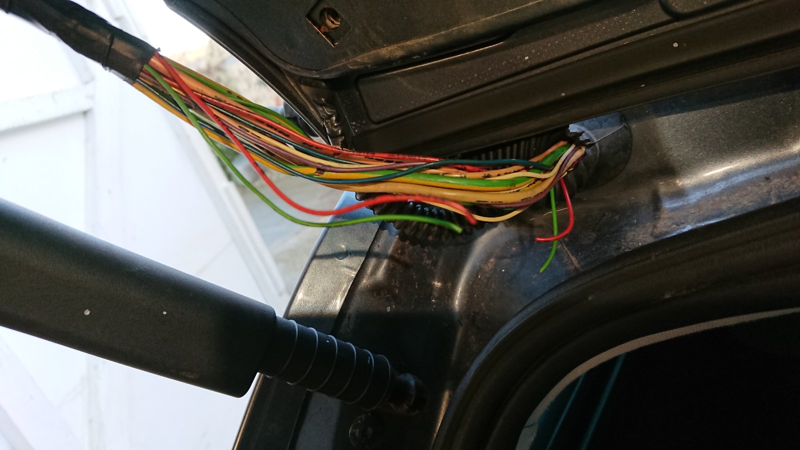

This is the fault. Broken wire somewhere?

Is is just the sidelights on the actual tailgate lid? Are the outer ones on the body working ok? If this is the case & you have replaced the bulbs then this is almost certainly a broken wire in the body to tailgate harness.
If you have no rear side lights at all i would look at the fuses next.

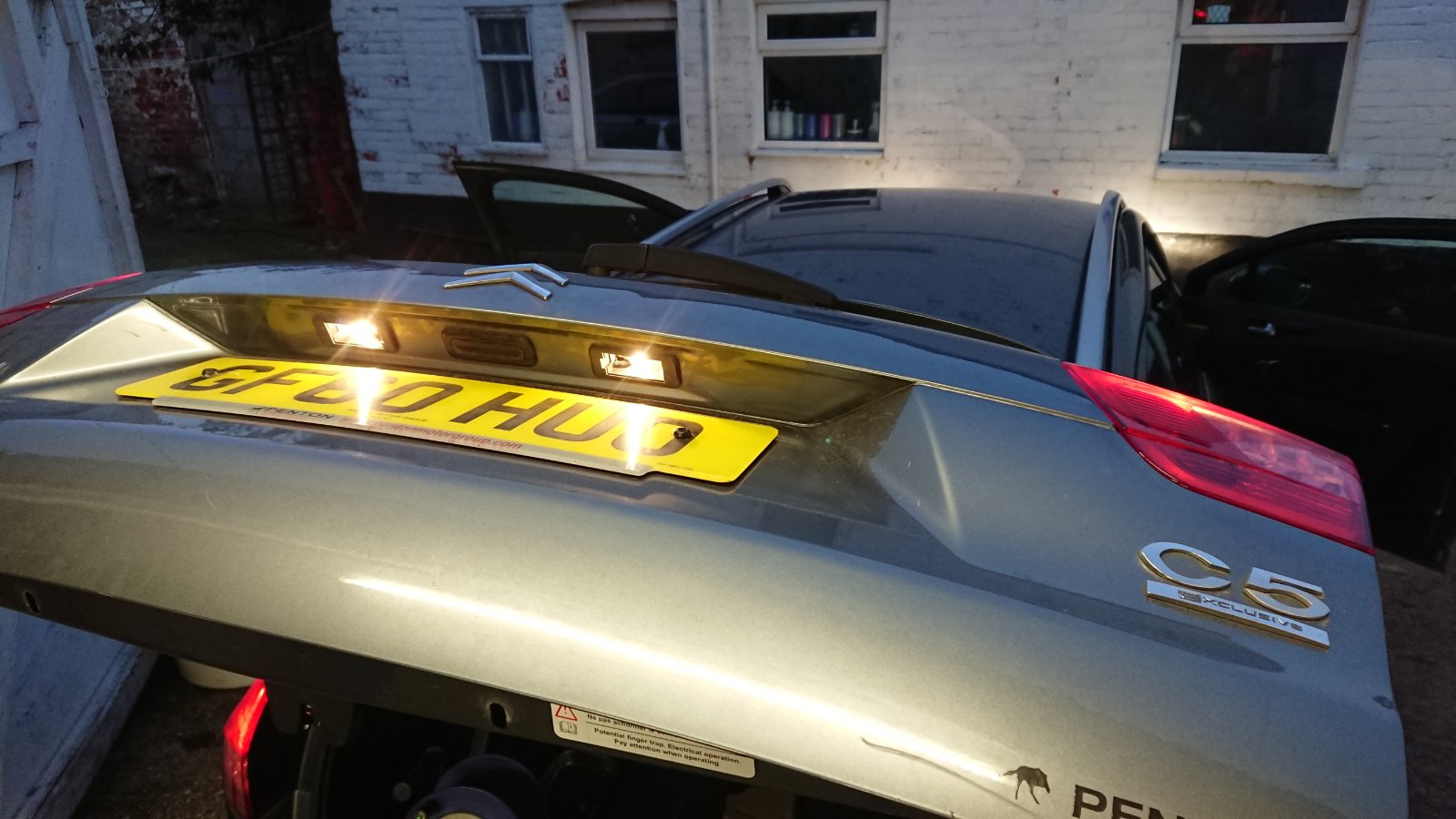

Thanks it did turn out to be broken wires. I was overthinking it.
x 6945
Re: C5 X7 tourer tailgate and number plate lights not working
This area in your last picture is a well known issue and the usual culprit.

Hopefully this thread will help someone in the future.
