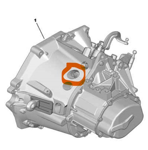

The switch should be located here.
Cant remember the socket size off hand to remove it but the socket needs to be quite thin walled as the recess it's in is quite narrow.

Great help mate-Thankswheeler wrote: 20 Oct 2020, 13:03 The switch should be located here.
