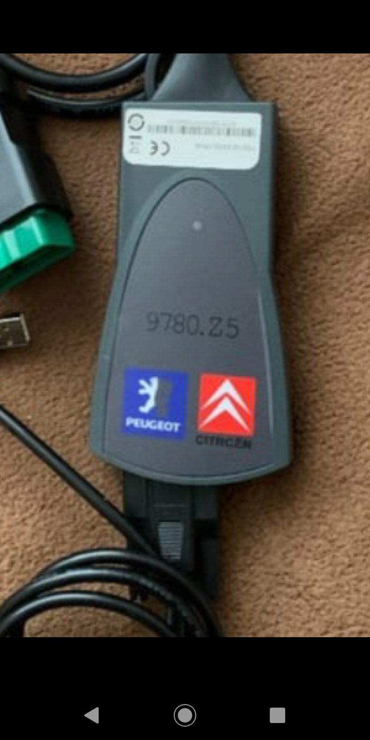

hi, I'm purchasing diagbox and cable for my
2003 C5 (rhy) and 2007 C3 (tu1a)..
would anyone know if this one is suitable?
Diagbox PSA XS Evolution 9780.Z5
I heard somewhere some have trouble with C5s??

That's no indication of the quality of the components and what hardware is on the boards or what is missing from the boards - price will be a rough guide though - anything under £100 may not be a full chip Revision C chip with full hardware. Without this, it will have trouble reading full CAN vehicles.
These are all clones, but they are not all the same - some are better quality and have the full hardware, others are a cut-down version and are generally cheaper.
For the age of your vehicles, you'll need Lexia. This is included with Diagbox and when it detects the vehicle, it should launch automatically - however.... You need to install Diabox on a 32 bit operating system because the encapsulated Lexia software will not run on a 64 bit operating system. So be aware of this.
Make sure you purchase from a UK supplier that provides support.
