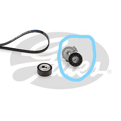

Re: Xantia 2.0l Hdi Aux belt
Hi All,
Thanks for response.
Have been researching the best belts and many seem to recommend the Gates belt kit.
I have found the exact Gates kit (K026PK1750) on ebay and the price was better than the Ridex kit.
Got better quality parts for cheaper than cheap parts lol, check link.
https://www.ebay.co.uk/itm/DRIVE-BELT-K ... 2749.l2649
Any advice on the process of changing the aux belt?
Changing the belt is relatively easy.
Lock adjustable tensioner through the hole into the engine I'm sure it's a 15mm, very long spanner required. Remove belt if locked properly it should slide off easily.
Release adustable tensioner using spanner. Remove and replace both rolling bearing and adjustable tensioner. Relock tensioner and place on belt, release tensioner and that should be it.
A brief description
Kenny
A brief description
As Kenny said. The only small thing to add is that you need some 4mm rod to make a locking pin for the spring-loaded tensioner.
There are a couple of good pictures here: https://www.astuces-pratiques.fr/auto-m ... tia-2-0hdi
It's in French, but once you realise "pige de réglage" means locking pin, the rest is reasonably obvious.
Hi All,
Thanks for responses.
The kit arrived and all looks brand new, is the top quality EPDM rubber belt (Gates) and 2 sets of pulleys, for manual and automatic tensioner pulleys. Only needed the 1 pulley.
The old tensioner released ok the old belt came off fairly easy, looks deteriorated (slightly threaded) and with chunks of the ribs missing. I wire brushed all the pulleys and got all the broken ribs out of the gulleys.
Is a complicated 6 pulley system and the belt returns at strange angle to the new tensioner pulley. Was a very tight fit even on the lowest tension, but eventually it lined up nicely and adjusted well. The belt doesnt go vertical when twisted by hand.
Hooked the battery up again and started the engine and the belt looks good and is working well.
Thanks again.
Steve
