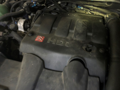

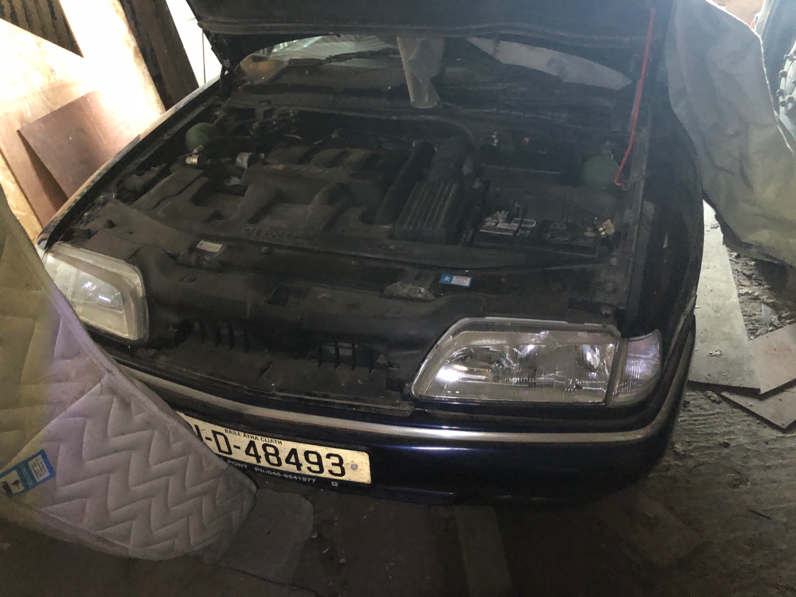

I’ve been offered a 2001 2L HDI Xantia that’s been lying in dry storage for a few years and I’m tempted to take it on - and save if from the crusher. I have owned XMs and CXs and a Xantia before and I found the Xantia 2L HDI very good.
The car is one owner from new 120k with a full Citroen history - belt at pump done at 100k - it was parked up and battery removed and covered up. I put a battery in it some fresh diesel and I can’t get it to start - it will start with a squirt of easy start and that’s it - I have checked for fuel at the injectors and that’s fine - I’m wondering if it’s an immobiliser or crank sensor problem - my OB2 code reader won’t communicate with the ECU so don’t know what codes are on it
Any ideas or pointers i can follow up on - the car is worth saving IMO

That's a great find! Looks well worth saving
An OBD2 Code Reader will not work on this car...
You need to get it diagnosed using a Lexia. It's likely to give you some positive pointers as to the area of the problem...
Otherwise it's little more than a guessing game with a low probability of success...

When you turn the key to the 2nd position, do you hear a hum for a second or so from the lift pump in the tank ?
Other suggestion, the engine ecu is easily accessible. It might be worth checking all the pins are clean.
Just remove the front engine cover. ECU is in the box by the 2 slot-head plastic fasteners
Otherwise, as Sir Jim says, it's Lexia time

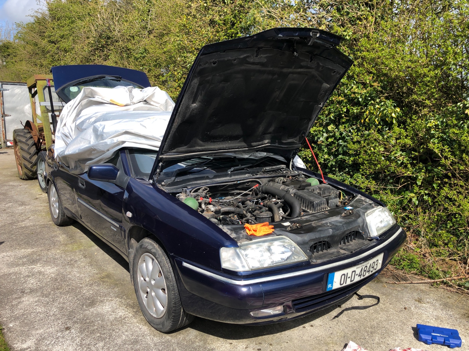

I got the engine running and it was a fuse - think it was fuel pump - it fired up literally first turn after been lying up for over 12 months
I parked the car up for the winter months (covered and kept snug) and I am now getting on with some basic jobs
Have an alternator problem - most likely regulator (bugger to get out..)
Need new Aux belt and tensioner (bugger to get off - have to let top engine mount go and jack engine up to get access to the securing bolt)
New thermostat and coolant - any recommendations for tensioner and coolant ?
oil and all filters - standard service
I have to replace front spheres
I might look at recharging the rear ones - seems to be an option -
I also need to deal with light surface rust around the back end as the car has been off the road for a few years - nothing too serious - (I HOPE )
Regards
Paul
