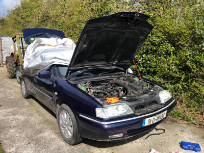

Hi Steve - sorry its taken me so long to reply to your comment -
I got the engine running and it was a fuse - think it was fuel pump - it fired up literally first turn after been lying up for over 12 months
I parked the car up for the winter months (covered and kept snug) and I am now getting on with some basic jobs
Have an alternator problem - most likely regulator (bugger to get out..)
Need new Aux belt and tensioner (bugger to get off - have to let top engine mount go and jack engine up to get access to the securing bolt)
New thermostat and coolant - any recommendations for tensioner and coolant ?
oil and all filters - standard service
I have to replace front spheres
I might look at recharging the rear ones - seems to be an option -
I also need to deal with light surface rust around the back end as the car has been off the road for a few years - nothing too serious - (I HOPE )
Regards
Paul
