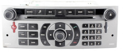

Hi everyone I've just bought a c5 on a 07 1.6hdi, the radio and satnav don't work, the screen lights up and says citroen then it goes blank and nothing seems to work. Anybody know what's going on because I really haven't a clue lol Thanks

Ok so on your MK II C5 it will be the older RT4 system:
Do you have the original Software CD with the car? If not ask your Citroen dealer to order you one on CD. The last version available is V8.11 (part: 9679242580) and see if that will fix the issue. They only cost a few quid to order so have not got anything to loose. They are not made anymore, so if the software won't fix it, try a BSI reset using this procedure:

It sounds like a boot problem - and this may be as a result of internal corruption / chip problem. You have nothing to loose trying to boot from the CD and see if that will restore the system, but failing that, it will likely need repairing or replacing.

I've been on line and looked for the same stereo system and I manged to find one for £180 with a screen.

Your screen should be fine and will save having to remove the fascia. Just make sure you code the new unit with your VIN and make sure you disconnect the battery before you remove / install the new one.
Also, you may have to configure the new unit to match your factory-fitted options.
