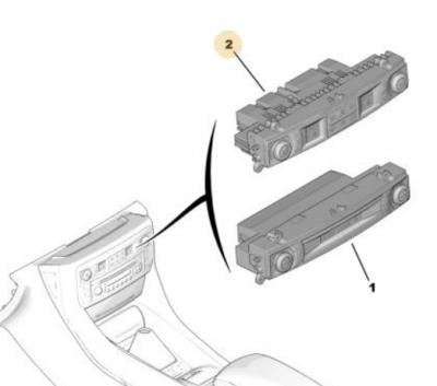

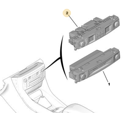

Secondly, these are completely different to the Climate Control panel - which again is a completely separate unit from what you are describing above and again available as a separate unit.
If you want the climate control panel, yours is item (2), 6452H8 is the part number that will also be the correct colour for the interior.
