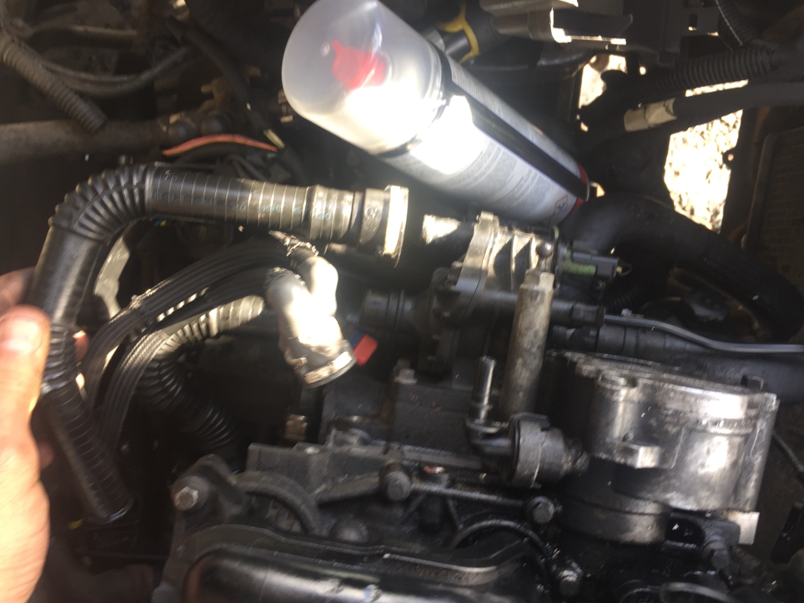

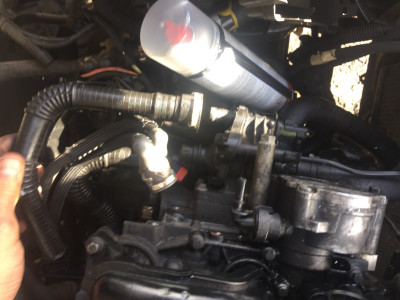

could someone please be kind enough to tell me the part number of this pipe please, runs from the water pump round the right side of engine to what looks like a T pice under the EGR pipes...also any easy way to replace it at said T piece or is it one long pipe all the way to the reservoir

More needing the info on is it a complete unit it’s only one pipe I have sheared there’s two attached together is it easy to switch over at the crankshaft(bottom left) of the engine...think it’s this part...not 100% sure tho added a pic

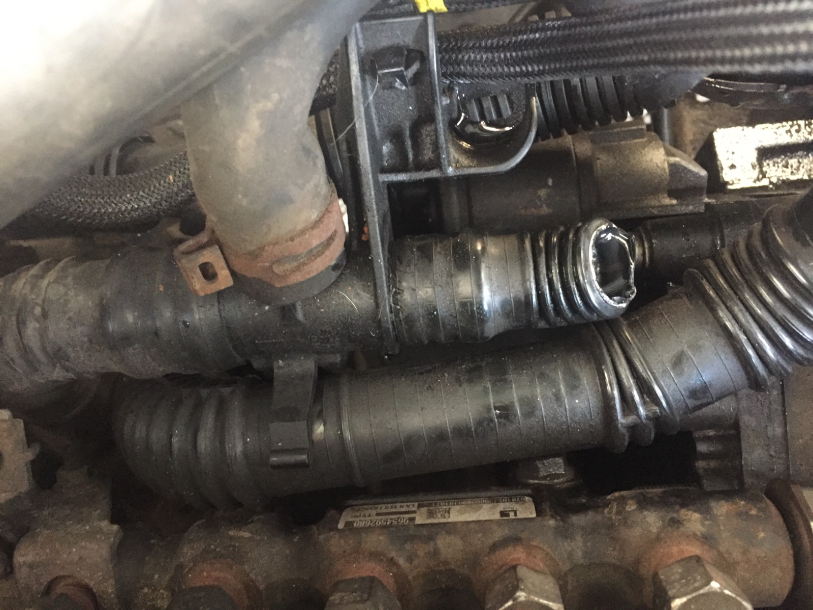

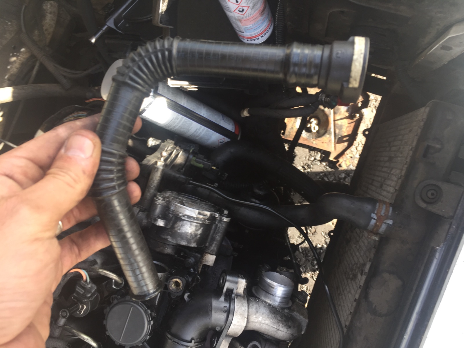

anyone else any experience getting it off real pita down under the fuel pump no access from the top gonna jack and support tomorrow try get it out from the bottom, ordered off eBay hopefully here Saturday...crazy thing is now I’m thinking it was only a ten minute fix in first place gave myself so much extra work to do bursting that pipe

I suspect that you will need to remove the OS drive shaft at least to get access. Quite possible the exhaust and subframe will need to come out, depending on how small and dexterous your hands are. I haven't got a procedure, but it appears to book at 3.5 hours....

Thanks Richard took me a bit longer than that just to get it out between yesterday and today lol thares a bracket carrying the main loom and I think fuel pump parts and pipes, once the brackets undone there’s just enough room to pull the pipe up from the top...the hose clip in behind the crank pulley needed done only by touch took me half an hour on it’s own
new pipe arrives tomorrow hopefully reassembly isn’t as long as disassembly on the plus side I did locate the crank shaft sensor which I’m hoping is the original fault, it’s seen better days I got one out the scrappys while rummaging the other day it looks almost new compared to the one I took off today...also have the full EGR setup at my back door gonna separate the bits and stick the pipes and valve in s bucket of cola overnite an give it a good scrub in the morning with EGR cleaner
