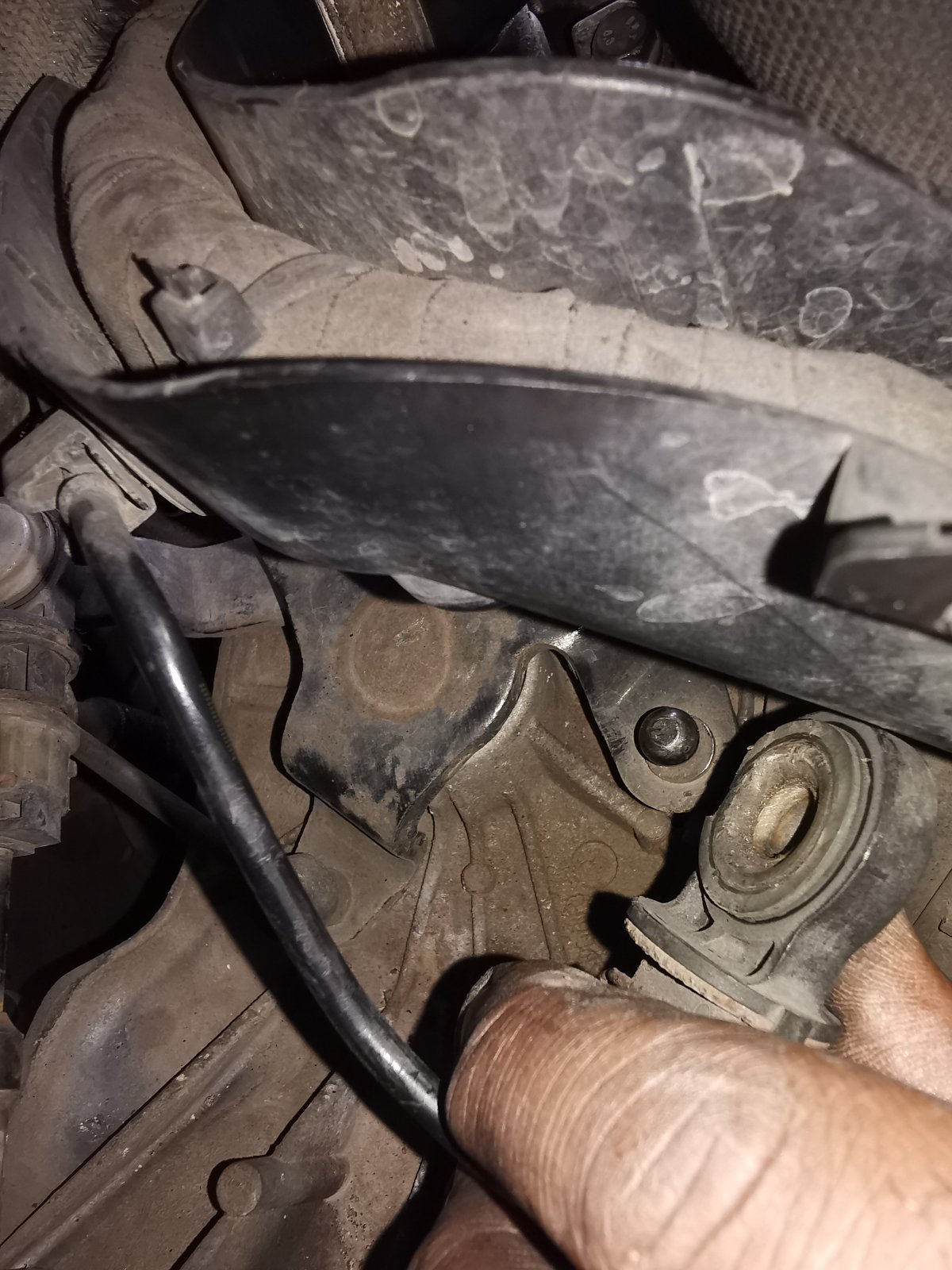

After the beautiful shame of being recovered from a busy retail park on Saturday because the car was stuck in reverse. I suspected the gear change cables and got home to have a look.
One of the cables had popped of at the gearbox end and its not going back on easily. Is this normal? Should it be super hard to get back on?
Strangely it also seems slightly twisted (70 degrees or so) when its off. will it be ok to twist this back and somehow clamp it back on or am i looking for a whole new set?
Looking at the cable it appears the end can be replaced by itself but i cannot find a part number or description for it anywhere.

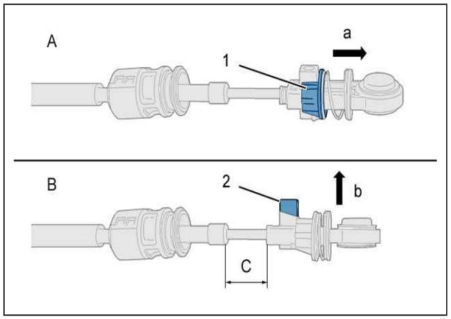

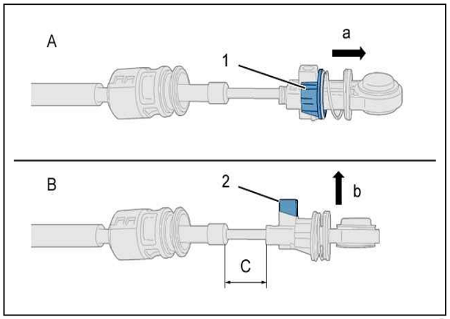

Just in case you don't have the procedure for unlocking the cables:
"A" : Locked position.
"B" : Unlocked position (Variable dimension "C" ).
Carry out the following operations simultaneously :
Move the cylinder (1) ; At "a"
Pull the locking key (2) ; At "b"

GiveMeABreak wrote: 07 Sep 2020, 14:05 Hi Martin.
As for the parts. There are spare parts available that include the spindle with the ball lock if needed. I can supply you with the parts diagrams and part numbers / current prices, but this does require a min £10 forum donation as PSA now charge us for the live data. IF you want to go ahead, follow the link below and your membership status will be automatically upgraded. This will cover you for parts info and parts diagrams for up to 2 years:
A response to your question by a forum admin will require detailed vehicle information that requires you to have made a current contribution to the Forum. Donate
Further Information
I'm struggling to get these apart on my 6 speed X7 gearbox! Does anyone know if there s a video showing this procedure anywhere please?
