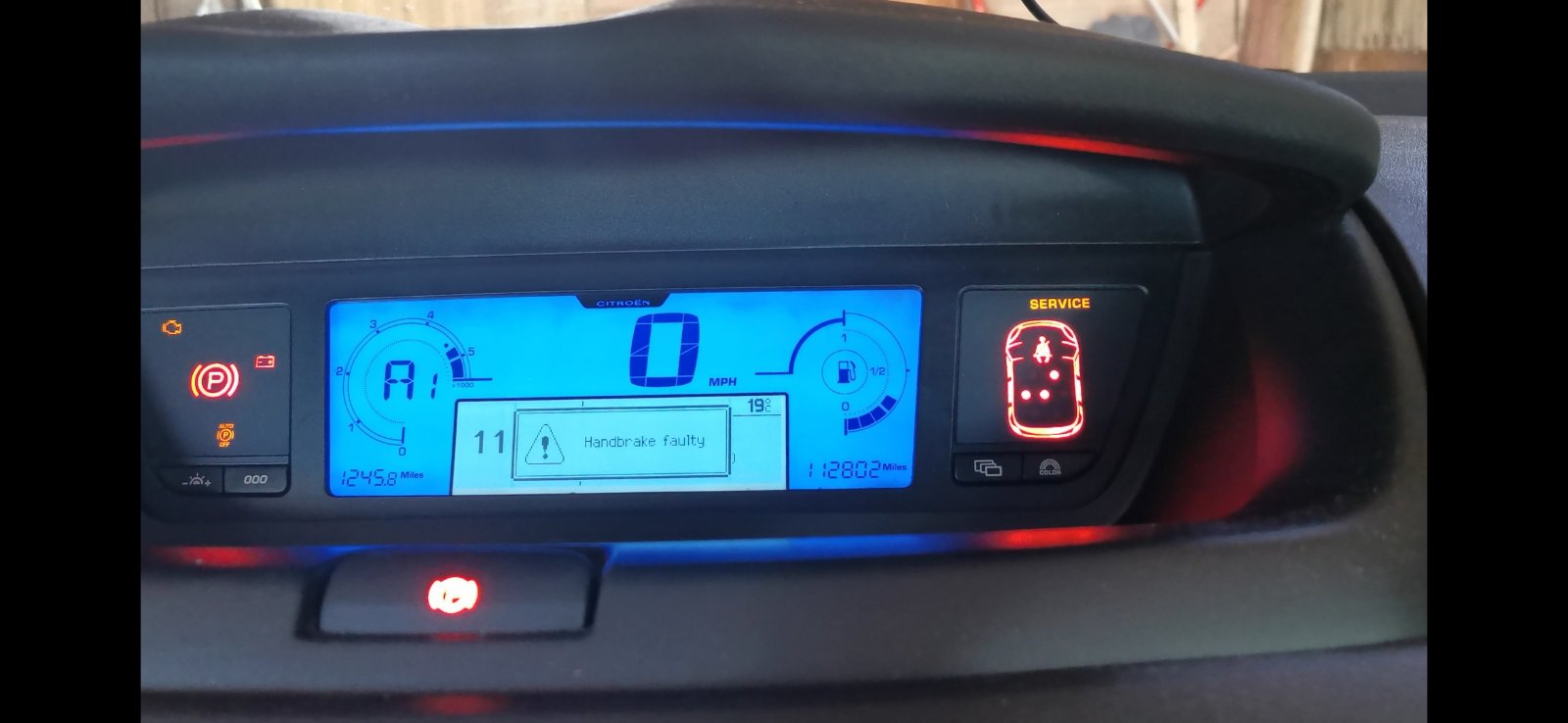

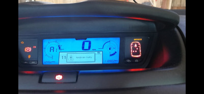

Hi all, I'm having a few issues with some faults that are coming up quite often now, had these come up last year and suddenly disappeared for 10 months, but now reappeared,
Handbrake faulty
Gearbox fault
Abs faulty
These come on quite randomly and car goes into limp mode, ie no higher than third gear,,if I stop and restart the car, and pull away the faults reae there but then dissappear when it goes to up shift,
Hopr someone has heard of these before..

I suspect you have an ESP-related issue as this system also controls the Electronic Handbrake.Flanders wrote: 06 Sep 2020, 18:17 Strangely whist being towed, all of a sudden my faults started to ping up, and when home, the car started fine

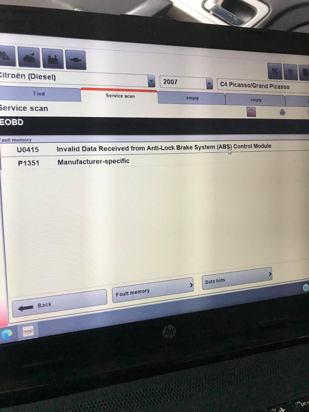

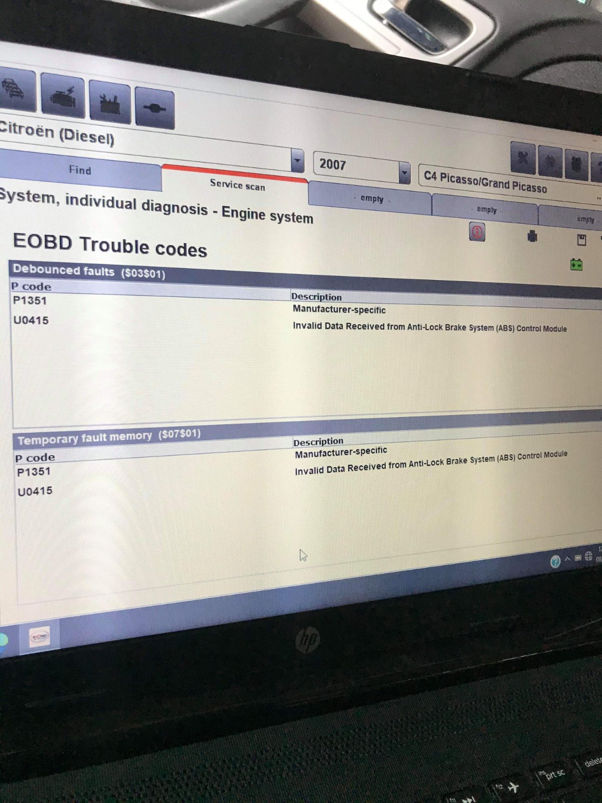

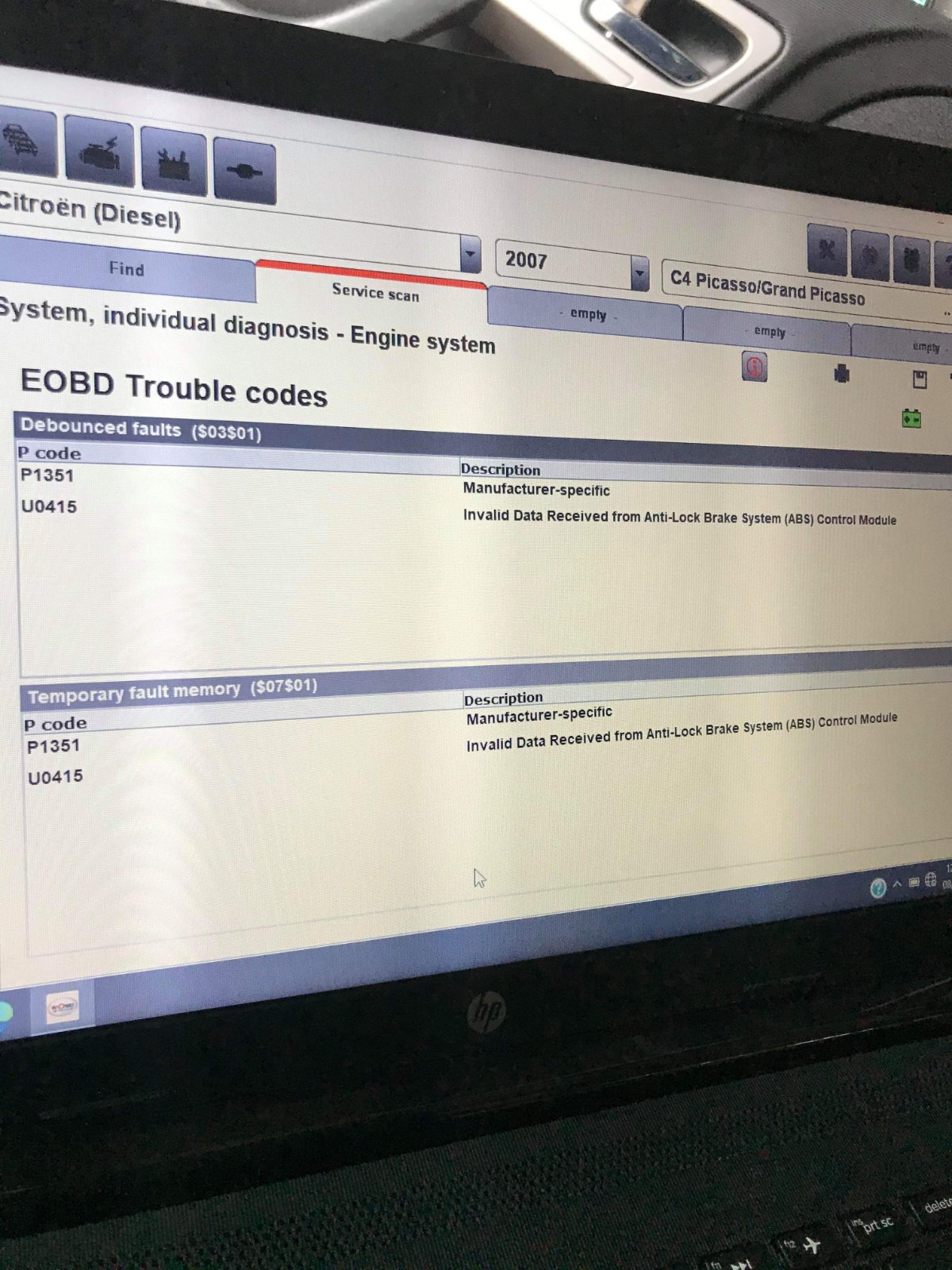

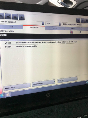

OK found as I already suspected speed sensor, I have purchased 1 to change and I believe the other is a glow plugFlanders wrote: 07 Sep 2020, 15:46 OK great thanks, I've got a chap coming round tomorrow to get the codes so fingers crossed, if not reckon I'll be scrapping the car lol

Ignore the 91351: Pre-heating relay circuit: Coherence - Relay supplied and glow plugs not supplied. This is a common one almost all HDis have from time to time.
Here's the descriptor of the main fault - so 3 possible areas - all inter-related, but a fault in the speed control system can cause issues with the other connected systems.
Fault code: U0415 Fault with the information sent by either the ABS/ESP ECU or the electric parking brake ECU: Value received incorrect.
Context of Fault code appearing:
Down-grade modes if fault present:
Suspect areas: 8-way harness of the piloted manual gearbox ECU, ABS/ESP ECU, Electric parking brake
- The average front wheel speed information on the CAN is incorrect.
- The time of appearance of the fault code is 1s
- Supply voltage correct between 8V and 16V (Pin 3 of the 28-way connector)
- No communication fault on the CAN
- Absence of fault codes U1000 - U1003 - U1113
- The system is not in starting phase
- The gears above 3rd gear cannot be engaged
- Change of gear impossible in the presence of additional faults (Input shaft speed, Engine speed, Gearbox input speed, Accelerator pedal position)
