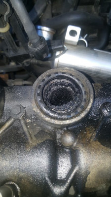

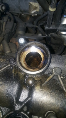

Re: Strange problem with 1.6 HDI - White/Gray Smoke
Pulling the intake of the engine i found this, first picture is the intake port for cylinder 4, and second picture is for cylinder 3, it looks weird that the one on 4 is clean, but 3 is dirty, i would expect all 4 to be equal.
