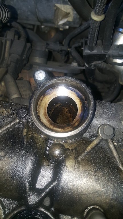

Re: Strange problem with 1.6 HDI - White/Gray Smoke
Pulling the intake of the engine i found this, first picture is the intake port for cylinder 4, and second picture is for cylinder 3, it looks weird that the one on 4 is clean, but 3 is dirty, i would expect all 4 to be equal.
Okay, even more of the engine is in parts, turbo is leaking oil on the exhaust side, the vanes/vnt are broken and missing parts, PCV valve is cracked and ripped, turbo actuator is leaking.
I would also check the injector seals on the engine. It's well known that the injectors can looses and oil can penetrate, turn to sludge and damage the seals, and once the sludge gets in it works its way round the oil chambers and gets into the turbo - once there it can obliterate the turbo.....
Some other info here with pics of this engine:
viewtopic.php?p=650153#p650153
The accepted solution seems to be frequent oil changes, (circa every 6k miles), check the turbo banjo bolt and ensure it has either the modified strainer in, or as some do, remove it completely and just replace the oil regularly, to ensure that turbo isn't starved of oil.
Injectors are also pulled out, will replace the seals before going back together, injector 1 was leaking, but it got caught in time.
I am replacing the oil feed line, oil pickup, and return line before refitting the turbo, also removing the strainer, it was missing a piece anyway, car had full service history, but i guess a s**t mechanic.
Problem solved.
4 "new" injectors, rebuild turbo, cleaned intake, egr, egr cooler pipe, and the car no longer cuts out at 3200.
