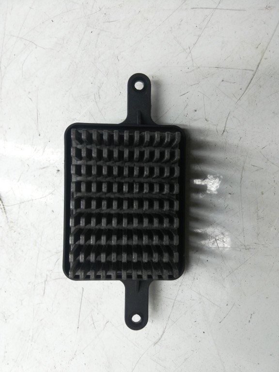

I've attached an image of the part I checked and couldn't notice any obvious damage.
- x 6957

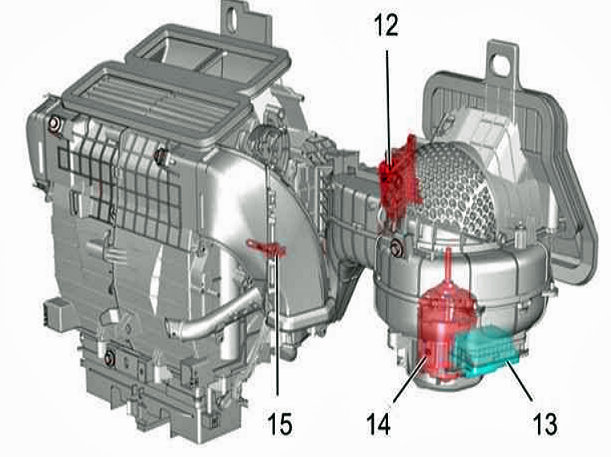

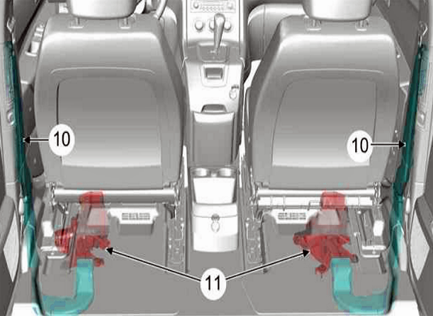

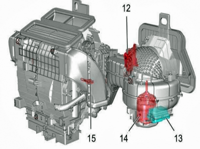

Ok, so as I suspected you have the main front blower motor and Blower Motor Control Module and there are rear additional blowers fitted under the front seats for the rear passengers. Each of these also has a Blower Control Motor.
So I suspect that your front blower motor control module is shot and and needs replacing. There is nothing visual you will be able to see to tell if it is defective.
If replacing the BMCM, a word of caution, don't be tempted to buy a cheap brand as they often last only a short time. Stick with a branded unit like Hella / BEHR / Valeo.
| Front Blower with BMCM shown at (13) | Rear Blower units for rear passengers with separate BMCMs |

Thankyou, I presume that's the part I removed yesterday. I'll take your advice and get a good unit and thanks again for the advice
