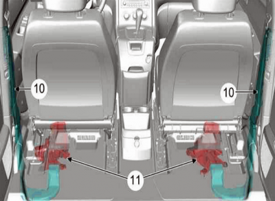

That will probably still be the air blower control module.
These can have the main blower motor for the front passengers as standard and optionally an additional blower motor for the rear passengers under one of the front seats for the rear passengers - and where that is fitted, will also have a separate blower control module for the rear blower motor attached to it. That is likely why the front one has failed and the rear one is fine.
Your VIN will help to confirm what is fitted.

Ok, so as I suspected you have the main front blower motor and Blower Motor Control Module and there are rear additional blowers fitted under the front seats for the rear passengers. Each of these also has a Blower Control Motor.
So I suspect that your front blower motor control module is shot and and needs replacing. There is nothing visual you will be able to see to tell if it is defective.
If replacing the BMCM, a word of caution, don't be tempted to buy a cheap brand as they often last only a short time. Stick with a branded unit like Hella / BEHR / Valeo.
Front Blower with BMCM shown at (13) | Rear Blower units for rear passengers with separate BMCMs |
