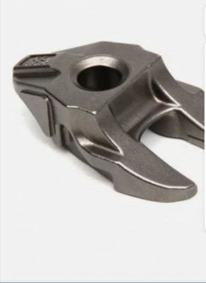

Hei!
I've just replaced one injector on my 508sw 2011 model 115hp. How much tightening torque do i need on the injector holder/forks?
Fork
Fork

Re: Injector torque 508 sw
Post by GiveMeABreak »
Pop your VIN up so I can determine the correct settings for your specific engine
Pre-tighten to 0.7 daNm
Then Angular tighten to 80°
Post by Wikkiwik »
Fantastic! Thank you
