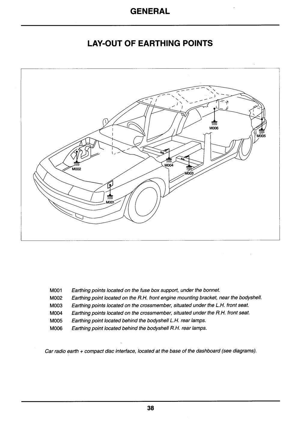

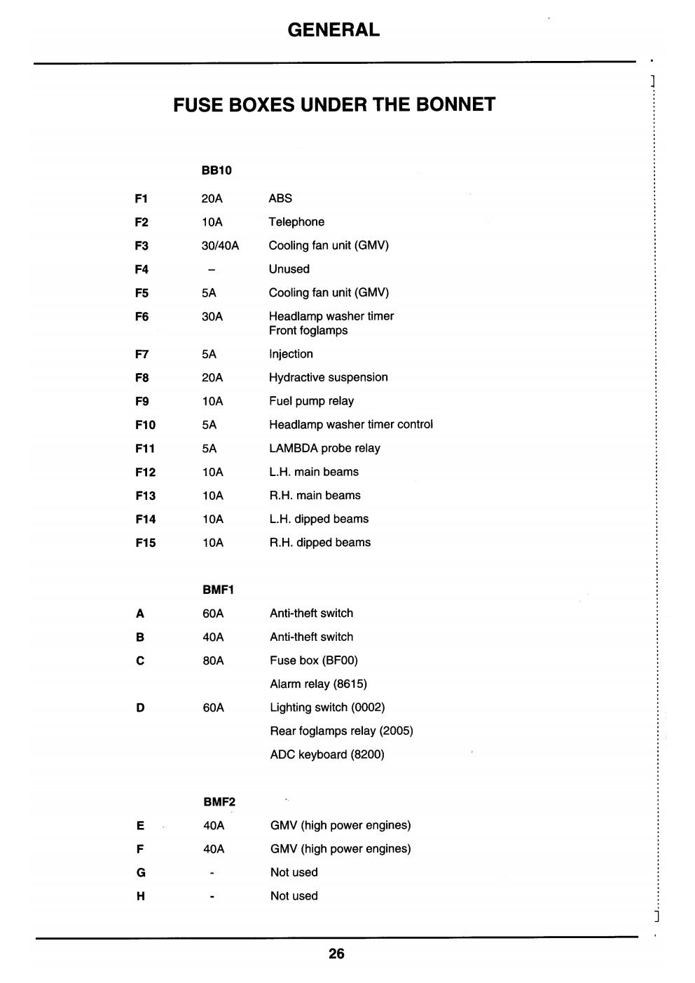

Does anyone have access to circuit diagrams for an S2 Xantia estate, please ? I'm grappling with an electrical fault.

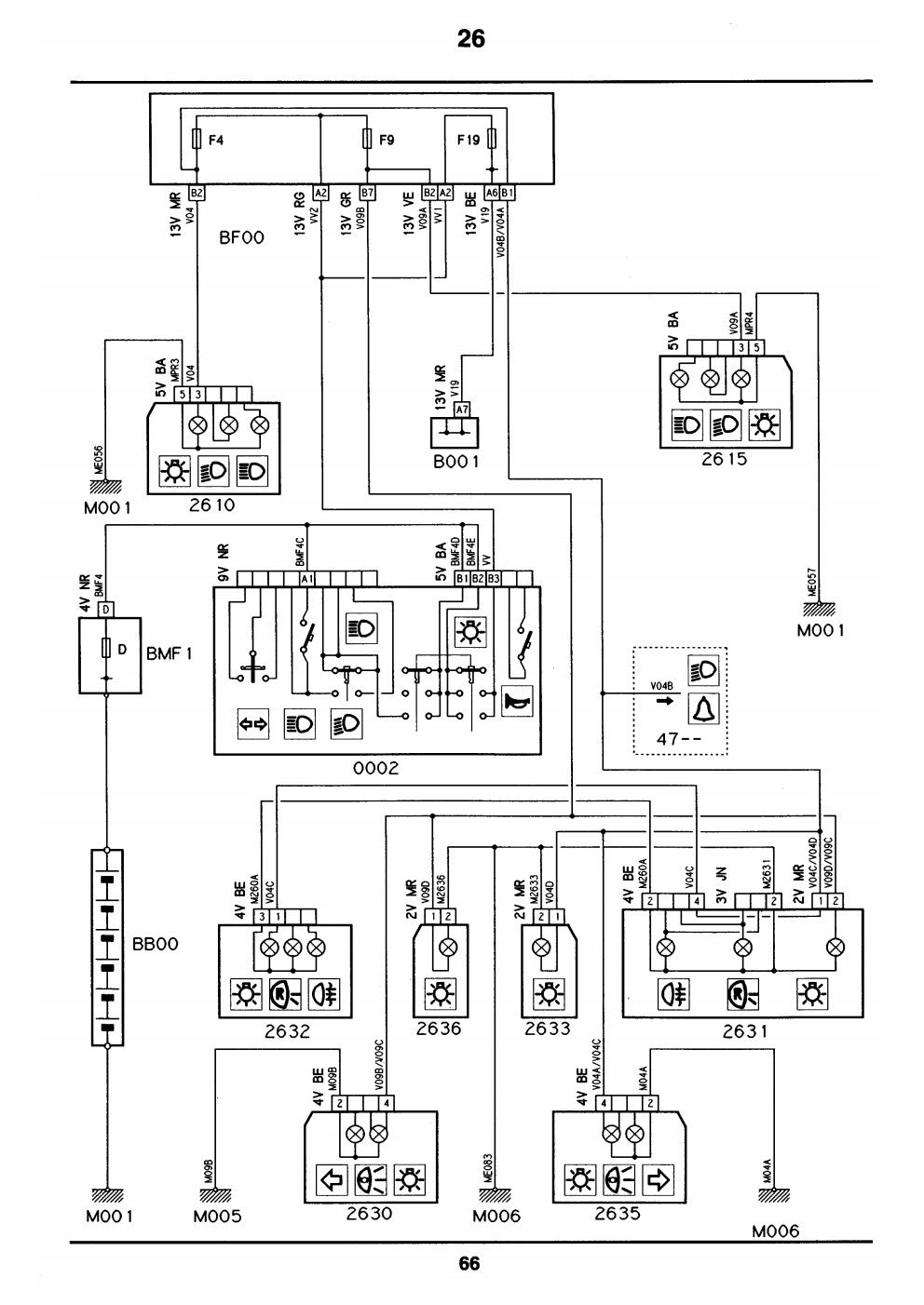

Andrew, put up your VIN, and I can post the relevant wiring diagrams for the items you list.

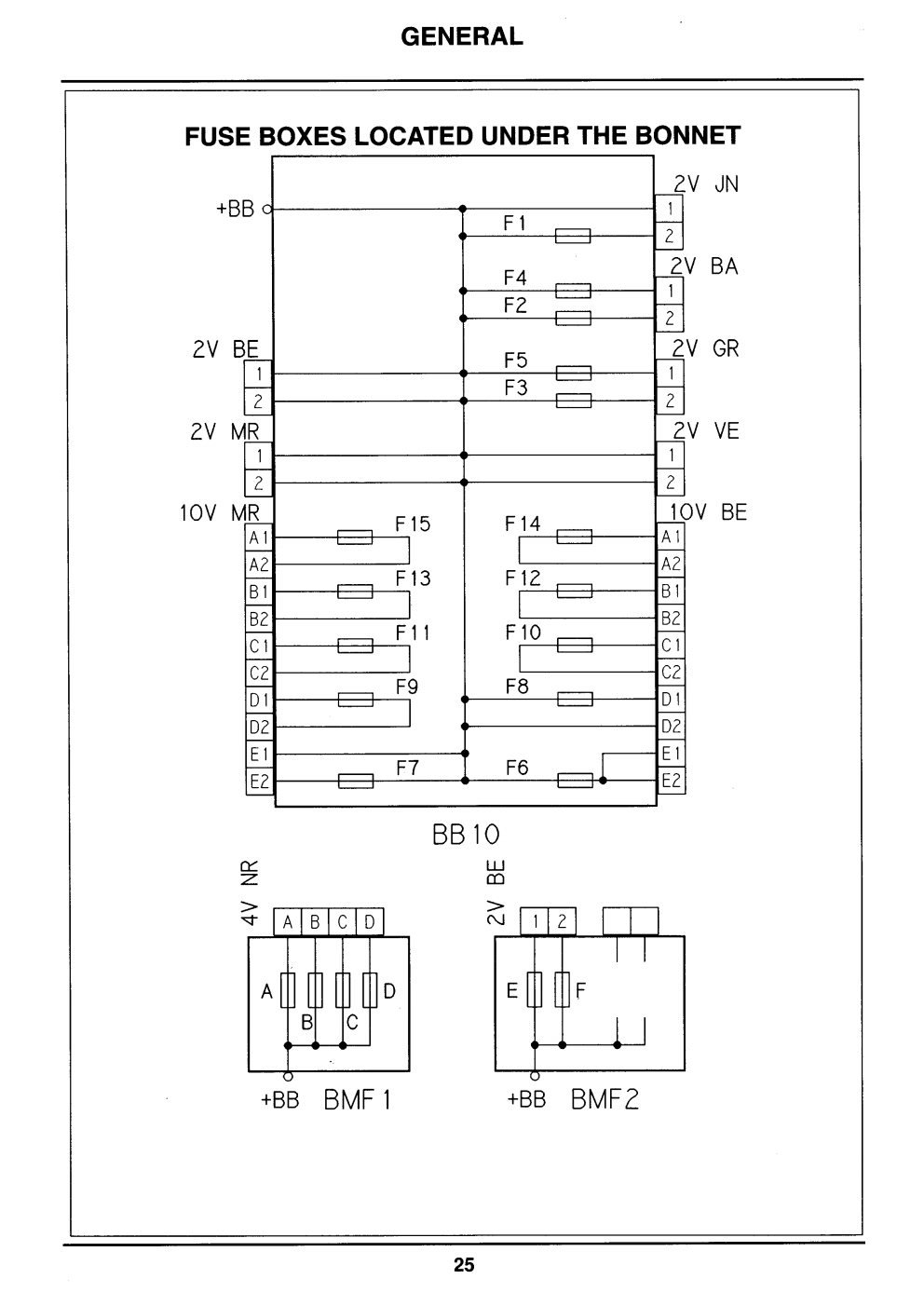

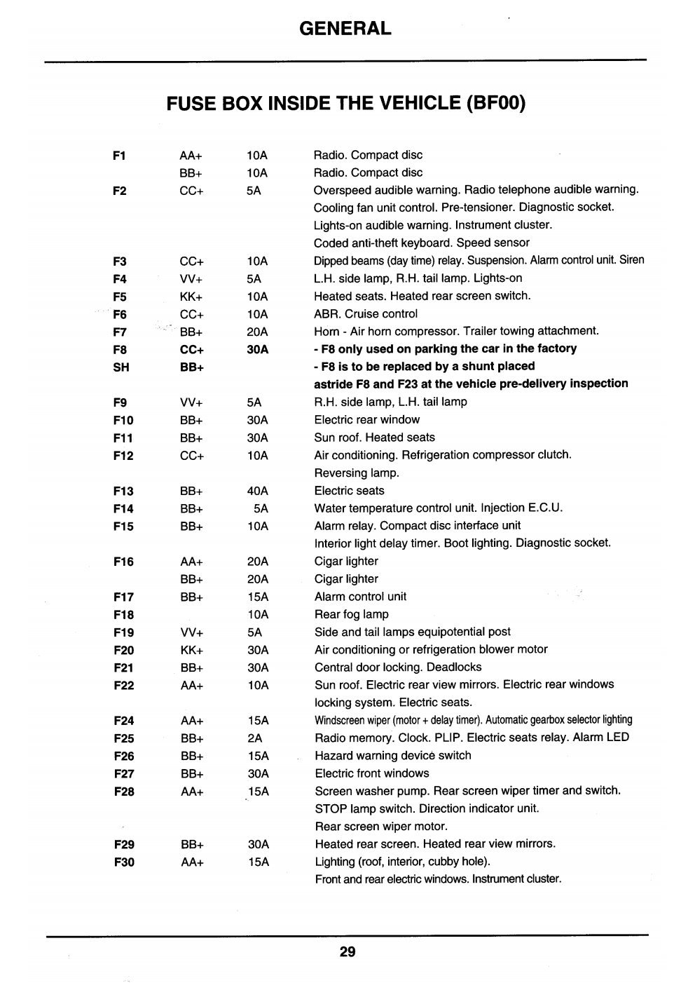

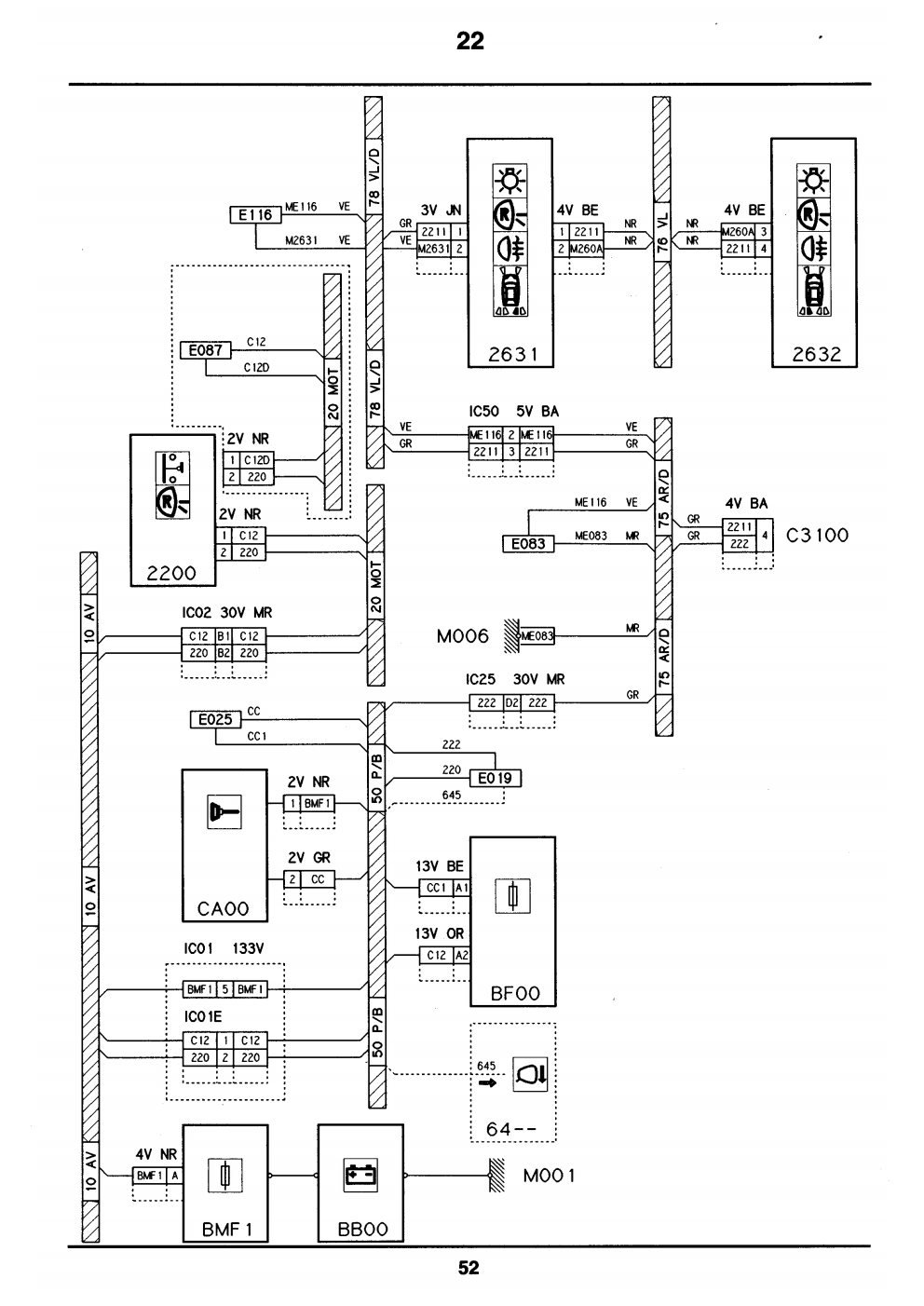

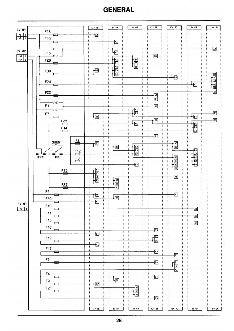

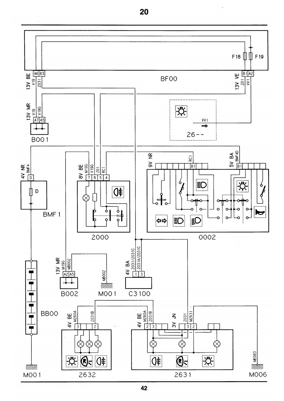

Re: S2 Xantia estate tailgate lights not working
Xan II 5dr Estate 2.0HDi 110 DW10ATED BVM5 RP.8549=5Apr2000
Hope these will help...
Click each to enlarge
Thanks Chris, that's incredibly comprehensive, thank you very much indeed for helping me here.

In case someone with a similar issue finds this thread, it is now fixed.
The three functions that weren't working, reversing lights, tail lights (in the tailgate) and rear fogs all rely on a single earth connection, just above the offside body lamp cluster.
As a consequence, I became fixated on the high current wire to that point. I started off replacing the section that goes through the rubber concertina and then went a step further, replacing that wire completely and bypassing the multiway plug adjacent to the earth point. Only when that failed to achieve a fix did I look further.
The cause was corrosion of the three pin connection on the offside cluster, where the yellow plug seats. Because the contacts are zinc plated steel, they didn't initially appear corroded, but when I looked closer, they were a different shade of grey from the others. Once cleaned them up and sprayed with contact cleaner, we were back in action.
