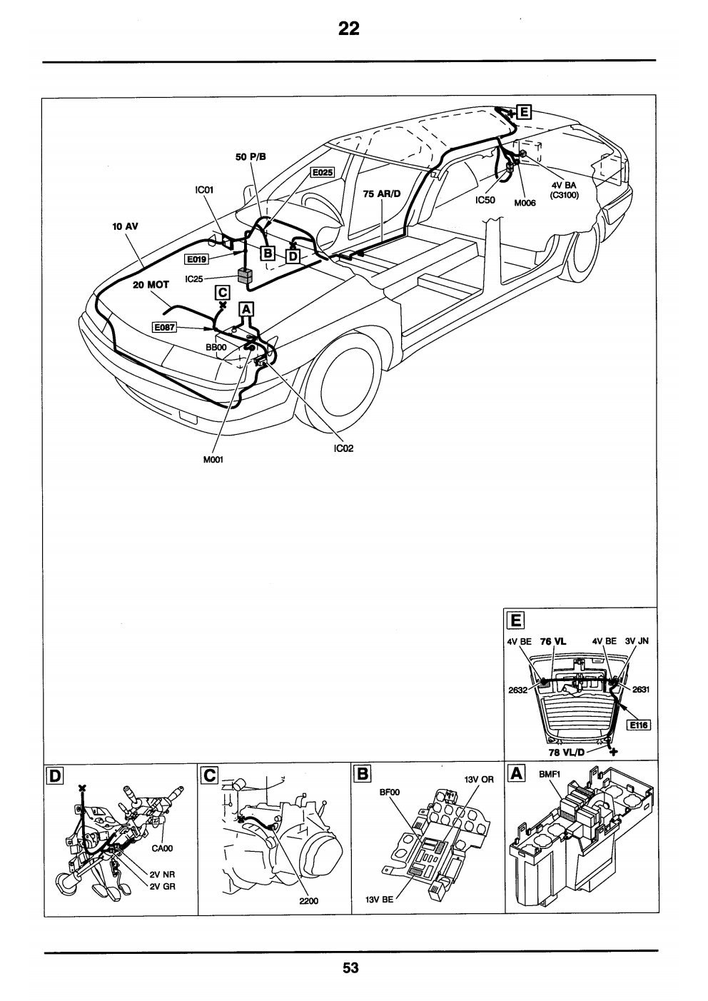

Andrew, put up your VIN, and I can post the relevant wiring diagrams for the items you list.

Xan II 5dr Estate 2.0HDi 110 DW10ATED BVM5 RP.8549=5Apr2000
Hope these will help...
Click each to enlarge

Thanks Chris, that's incredibly comprehensive, thank you very much indeed for helping me here.
