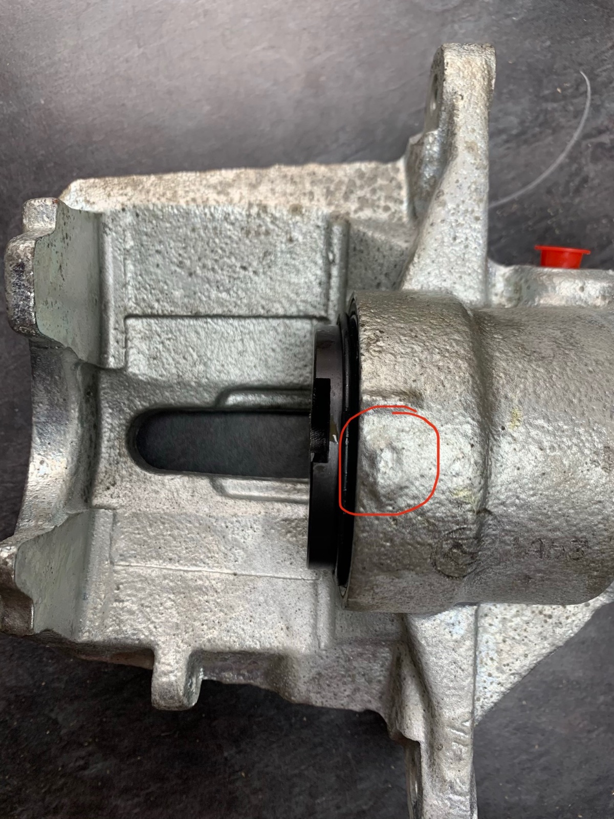

If you look closely at the underside of the calliper on C5’s there is normally an arrow to show you the direction to wind the piston, its not always instantly noticeable as it is usually caked in brake dust & dirt. You can just about see it in the pic below.
Wind back cubes are handy & great when the piston is nice & free but they dont put any inward pressure on the piston as they turn. You can buy a half decent (fine for the odd diy job anyway) wind back tool kit with both left & right hand thread tools for under £20.

The arrow picture and comment is worth it's weight in gold and takes all the uncertainty out of the operation once you know about it - where else but on the FCF. The wind back kit also keeps the piston straight.

Thanks Andy, I have cleaned up the underside of the caliper and I can see what looks like ancient hierogylphics, but not a clear arrow. I have some previous form, by the way, as I have owned Xantias for the past 20 years but have never had this much hassle with brakes. I have seen the arrows before and I suspect the Xantia calipers have been OE fitments so given the circumstances I am tempted to get a new caliper if I can't sort this by the end of today as I/we need use of the car.
