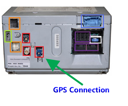

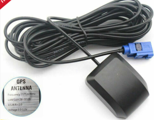

A few things I would suggest.
1) Test the internal GSM phone - does that work (as they use the same aerial)?
2) Before attacking the aerial on the roof, you can purchase a cheap GPS aerial that you can plug into the back of the NG4 (blue connection is the GPS) and stick it on the dash temporarily, then go for a spin. If the satellites come back you'll know it's an aerial issue - if not, then it may be internal to the NG4 unit Steve.
Something like this for £6.49:
https://www.ebay.co.uk/itm/Fit-For-VW-R ... Sw35Be~H5m

Did the reset today and it’s the same, replacement aerial ordered.

replaced the antenna this morning and the nav is working again.
Rather than take the headunit out and start faffing, I cut the end off the new antenna and plug off the faulty roof antenna and spliced the 2 together as a temporary fix. I'll get a proper replacement sorted soon.
