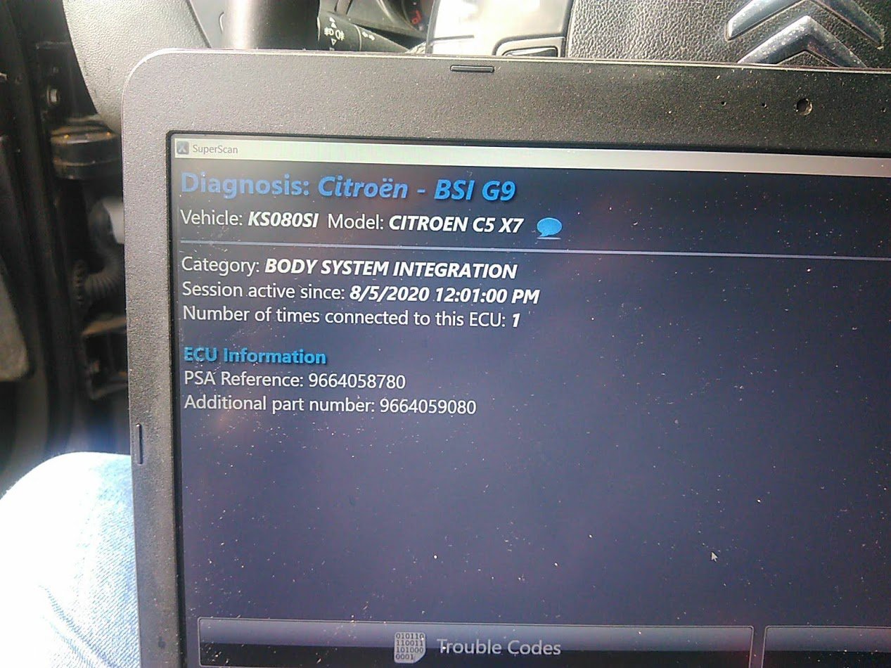

Can somebody tell me what model of BSI is mounted on my C5 X7 VIN VF7**************[VIN obfuscated, can be read by forum staff] YEAR 2010 TOURER... and what is C5 x7 and C5 x73c?

Re: C5 x7 OBD ELM
We don't need any more info - the VIN is sufficient, but won't provide 'model numbers'. We can only supply you with part PSA numbers. Other info regarding your BSI will be on the BSI unit itself on the label.Doxat wrote: 04 Aug 2020, 01:23 Can somebody tell me what model of BSI is mounted on my C5 X7 VIN VF7**************[VIN obfuscated, can be read by forum staff] YEAR 2010 TOURER... and what is C5 x7 and C5 x73c?
Here is a typical example of a BSI label and this is NOT specific to your C5 - just a sample.
Your problem is not likely to be with the BSI - it's probably the software limitations or your diagnostic interface.
You really need Diagbox for near dealer -level diagnostics. Not all aftermarket readers are fully compliant - some may not be fully CAN compliant and others have limited software capabilities to read all the ECUs.
I wouldn't touch the BSI though unless you know it is faulty and you won't know that unless you get it properly diagnosed. Just because an aftermarket won't read it, that doesn't mean it is faulty.

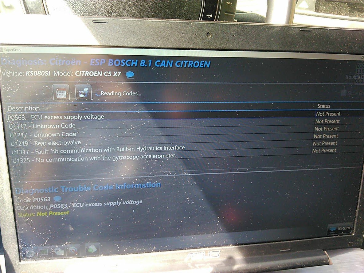

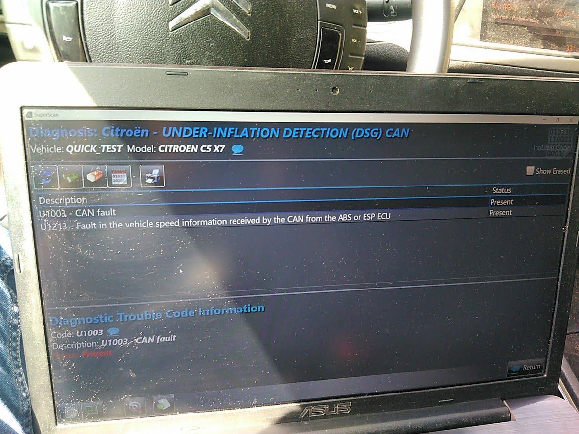

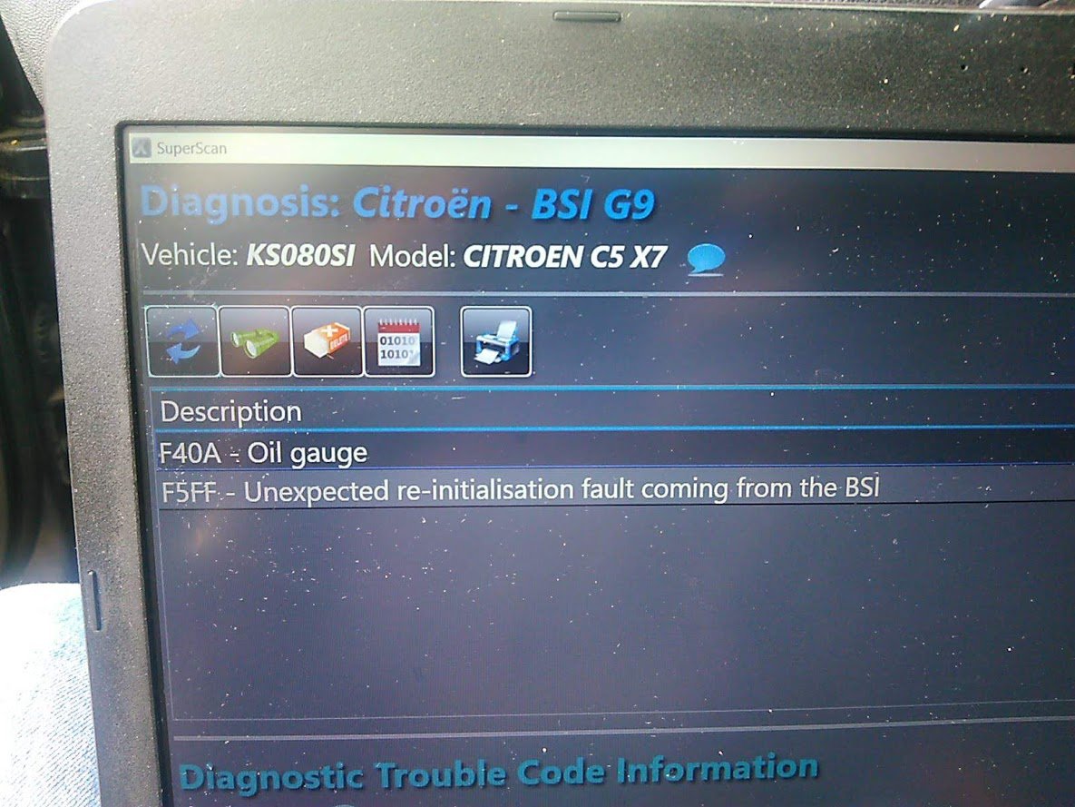

I said that for some 3+ years, aftermarket dongle ELM327 was working perfectly, and I could follow ower phone, all needed data. After one (five) phone calls, during one reading sessions, something happened, and could not connect phone any more to the car.
After that, idea was that dngle was damaged, I bought new one (more advance), and connect it...also nothing ower phone, but with both bluetooth dongles I can connect ower PC to the car. I have some readongs, but all apoint to an error in communications. Probabl in CAN - High line (PIN 3)... and there is some problem.. I am still working on it..
Some examples in photos:

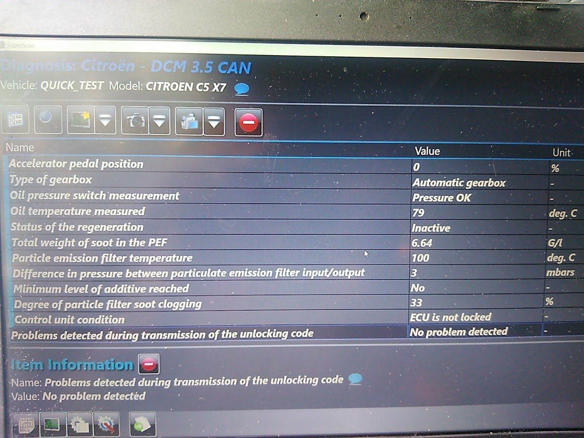

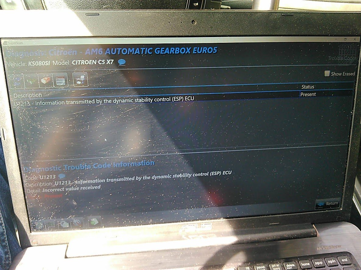

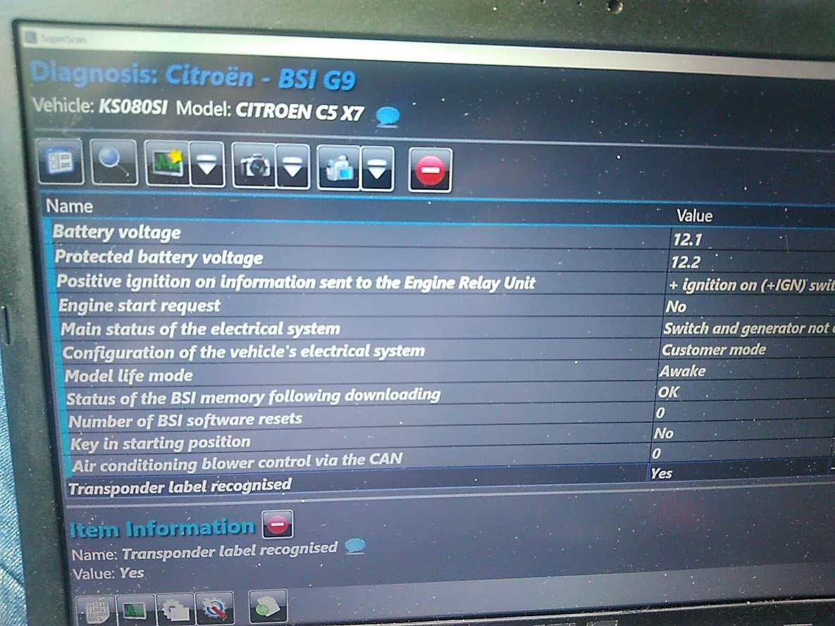

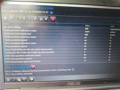

Re: C5 x7 OBD ELM
Maybe somebody can also recognise something, and suggest some actions, from the data:
This is also from previous session:
So, by my opinion, there is some mess in internal communication, probably in CAN - H line (that is on PIN 3), because, when I follow software, is always more slow, and do not recognise certain things when is trying to read from PIN 3 from EOBD. Also, errors are faults that usually can be found in similar system corruptions... I will continue to research, and inform You... maybe will be useful to somebody...
- x 6957
Re: C5 x7 OBD ELM
Ignore F40A. The oil level is measured up to a certain engine coolant temperature. Fault code F40A is recorded if the oil level has not been measured, as the temperature of the engine coolant was higher than the set threshold. Fault code F40A will be cleared from the list of faults in the built-in systems interface when the oil level is next measured.
F5FF can also be common - often fixed after a BSI Reset / Battery Disconnect / Reconnect Procedure. This can happen when either the battery has been disconnected and the reset procedure is not followed correctly - and with diagnostics kit interrogating the BSI on and off.
Make sure your battery is in a good state of charge.
