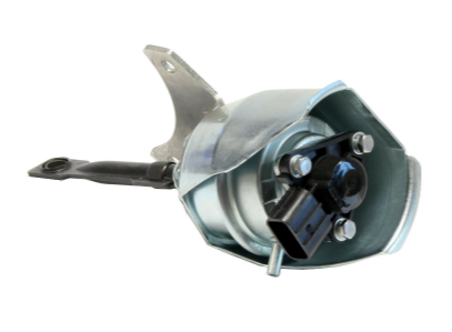

This is the circuit and you can see that item (9) is the pneumatic capsule for the pressure regulator control arm and (8) is the Turbo Copy Position Sensor.
Now there was a replacement control capsule kit for this as seen below - but Citroen no longer sell them. You can get these elsewhere like here:
Or you can just buy the sensor itself - here:
https://www.eurocarcare.net/fuel-manage ... ensor.html
Although they are out of stock at present - but they are available. Quality can be an issue -so beware of really cheap ones.
But at least you can check the wiring connections now you know what you're looking for.
