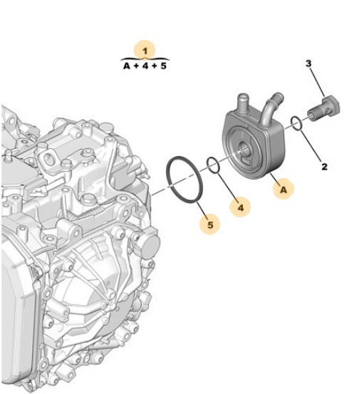

Have a 206 03 plate 1.4 petrol auto here, just acquired, belonging to my daughter. The classic signs of HGF. Oil dripping down onto aux belt from HG line on off side of engine block. Creamy brown on expansion tank cap and black oil inside the tank. First line of attack. Is there an oil cooler to check with it being auto? Got to do the HK anyway but need to look for associated or other possible causes first. Thoughts please. 53k miles on car.

Re: 206 head gasket
So yes, this has the oil cooler as seen in the diagram.

Re: 206 head gasket
Thanks Marc. Anyone any experience of these coolers failing...........and fixing them? Still probably needs HG doing anyway but will look at this too.

Re: 206 head gasket
Those oil coolers have been known to fail. As you say you have an obvious head gasket oil leak, so replace that cooler at the same time, it wont be very expensive.

Re: 206 head gasket
If there's oil escaping the HG then chances are it needs doing anyway, but the oil/coolant mixing could also be the thermostat housing on the gearbox end of the engine. Our '06 1.4 had oily coolant and it was the plastic housing not being sealed to the head properly, but they do warp/crack too sometimes.
