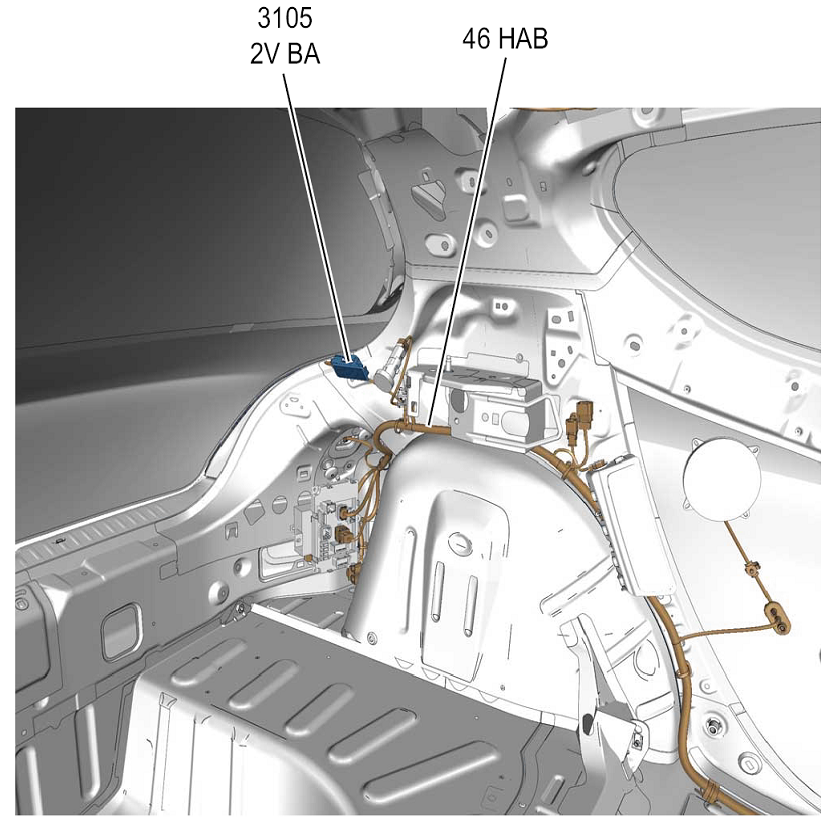

You may have a faulty lamp switch:
3105 is the lamp switch unit. It's got a 2 pin connection - earth and power. The power is controlled from the BSI. So check the wiring connections and secondly, clean up and check the contacts where the tailgate closes and makes contact with the boot area. Normally you should have some metal contacts near the locking mechanism that can become dirty or oily and this can prevent the circuit from completing when the tailgate is shut.

The picture you shows is left side of the boot??
- x 6954
Re: Boot light
Yes, on saloon models, that's where the trunk light is. But the contact plate is usually near where the tailgate / boot lock engages in the middle.
