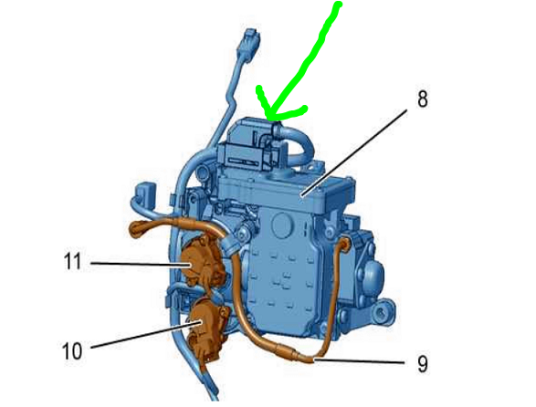

Re: ET6G gearbox fault
So 2 things:
1) When you replaced the brake switch, check the locking of the brake switch: The force required for locking is slight at the start of the quarter turn and goes beyond the point of resistance at the end of the quarter turn to validate the locking. If it's not locked properly it can cause an operating fault.
2) The next thing I would check considering the work you have done is to check all the electrical connectors to the piloted Gearbox ECU. One of the recommendations and could easily of been disturbed or damaged during the repairs.
I have highlighted the 28 pin connector to the gearbox ECU below with a green arrow. Check this connection, and also the gear engagement (10) and gear position (11) sensors shown:
