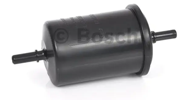

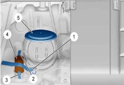

^ That 's not absolutely correct. It depends on which model of 1.6 he has. There are C4 Petrol models like the 1.6 THP and others that have a fuel filter - it's just not in the engine compartment, but usually visible just by the fuel gauge pump under the rear seat...
