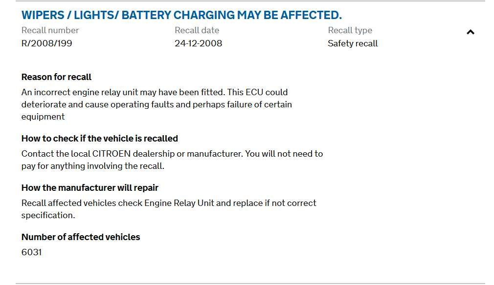

There was a safety recall regarding charging issues, though your car should be outside of the scope of that. Maybe worth doing a more indepth check relating to the recall number and your car's build date.
https://www.check-vehicle-recalls.servi ... 08/recalls
- x 6957
Re: C5 X7 Alternator Issue
His build date is 09/05/2008, so would be included in that - but I've ran his VIN and there is no outstanding recall listed.

IIRC, there was someone who posted up a couple of years ago who had a fusebox fire on a C5 X7 that was outside of the recalls... but it still caught fire ! I've always been a bit dubious about the dilligence and accuracy of the listed recalls. I even contacted the DVSA/DVLA/DVLC/whatever they're called today to point out errors in their listings - it took them several weeks to get back to me and confirm the errors and that they would update them

Sorry, should have been more accurate, I was referring to the wiper recall on mine, not the fusebox recall on the OP.
