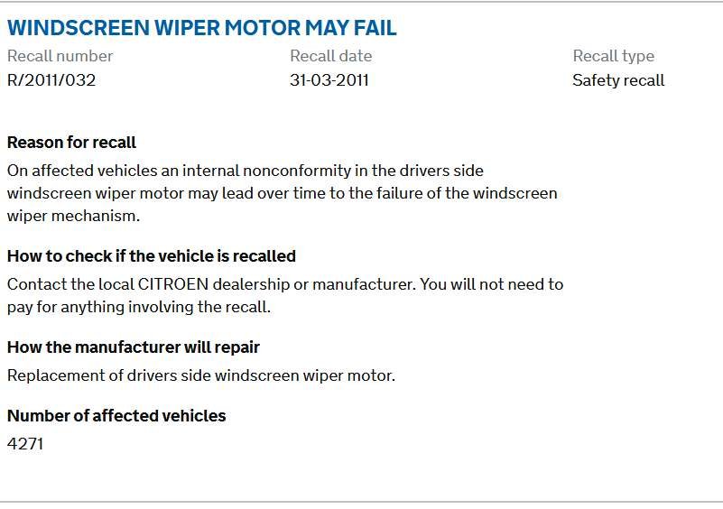

- Posts: 6847
- x 3565
Re: C5 X7 Alternator Issue
Sorry, should have been more accurate, I was referring to the wiper recall on mine, not the fusebox recall on the OP.
https://www.check-vehicle-recalls.servi ... 09/recalls

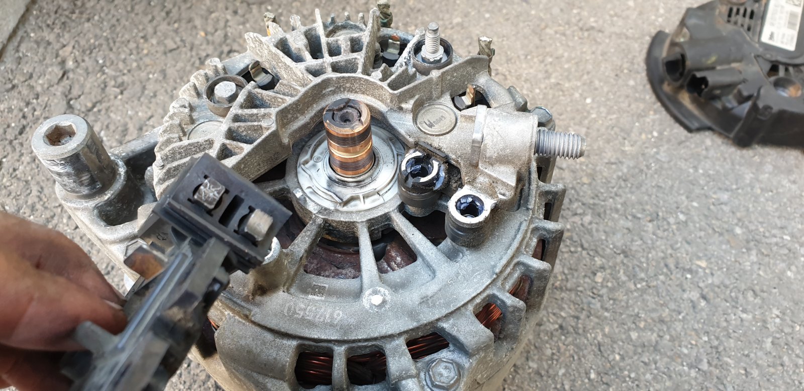

FlyMike_88
- Posts: 37
- Joined: 21 Jun 2020, 00:00
- x 3
Okay so I disconnected the battery and checked the connections, all look good. No visibly frayed cables and connections are clean.
When at idle before revved, the battery sits at 11.7v and a check of the alternator live shows 11.7v also. When revved to 1.5k rpm and dropped to idle again, I rechecked and the batt is at 14.1v as well as alternator.
Here is the battery
and the alternator
Here is the battery
and the alternator
Maybe the regulator brushes are worn or almost worn or the regulator is faulty. I had a similar issue last year when coming back from holidays and the alternator stopped from charging. Only knocking with a spanner I managed to arrive home after 1500 km.
