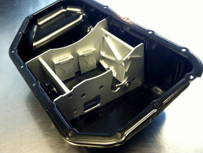

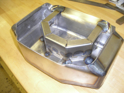

I do own a 405 with xud9 they are very slow, the TD and N/A are night and day difference, one part that will need significant modifications is the oil pan, the Niva has a front diff right undernight the engine, i'm thinking modifying a steel oil pan will be easier and better when off roading, my question is what to do about the baffling inside the pan, the factory engine has problems with this, on hard left hand corners the oil pressure drops to 0.

Re: XUD9 Engine Swap Any thoughts...
I was thinking something like this.
