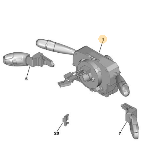

Just out of interest, what is item 20 in the diagram?
If it’s yellow and sits on or near the spring that s linked to the steering column height release, mine was in pieces. But don’t think it’s relevant for my problem!

That LOOKS like a simple cover for the space for the cruise control stalk. Not all cars have cruise control (which means the CC stalk is not fitted, so to prevent anything getting into the unit this hole would be covered). There is normally only one, as (to the best of my knowledge) there always is an audio stalk fitted.

It's called the 'Secondary Control, Support Block' and is for vehicles without the speed control stalk on the left.chasqui wrote: 27 Jul 2020, 16:28 Just out of interest, what is item 20 in the diagram?
I'm a bit more concerned about the yellow object you are referring to - it's usually the airbag wiring connection clasps that are yellow plastic, so I would be a bit cautious there.

The yellow item definitely came from the spring on the steering column linked to the locking height adjustment mechanism lever.
