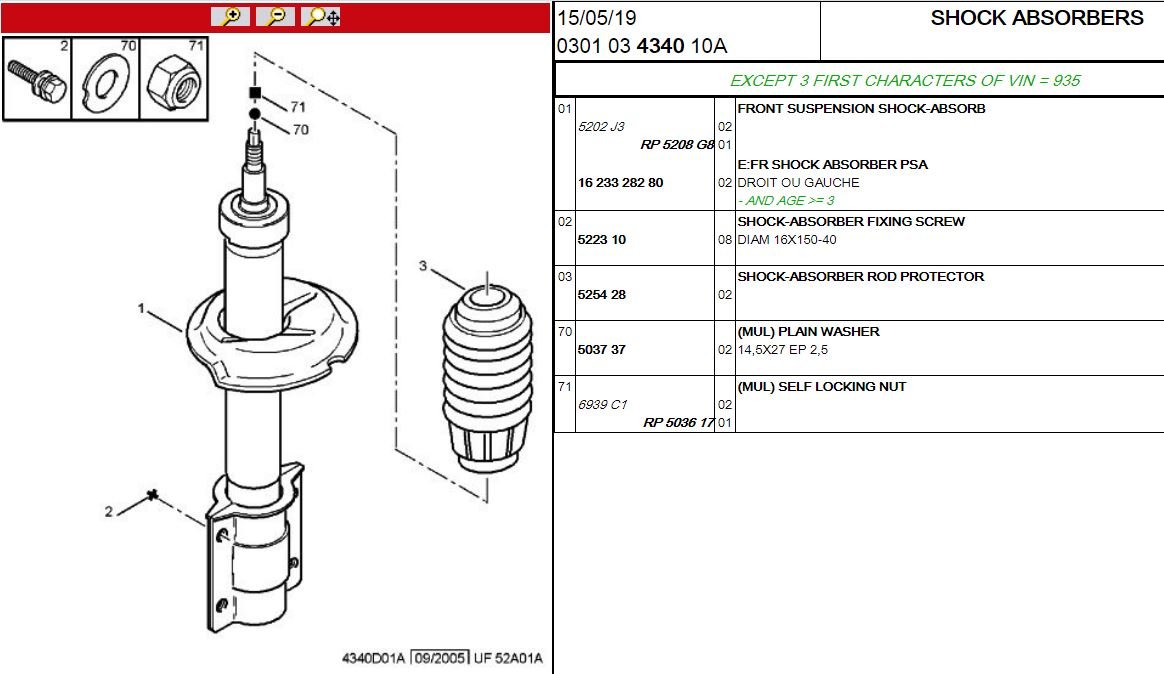

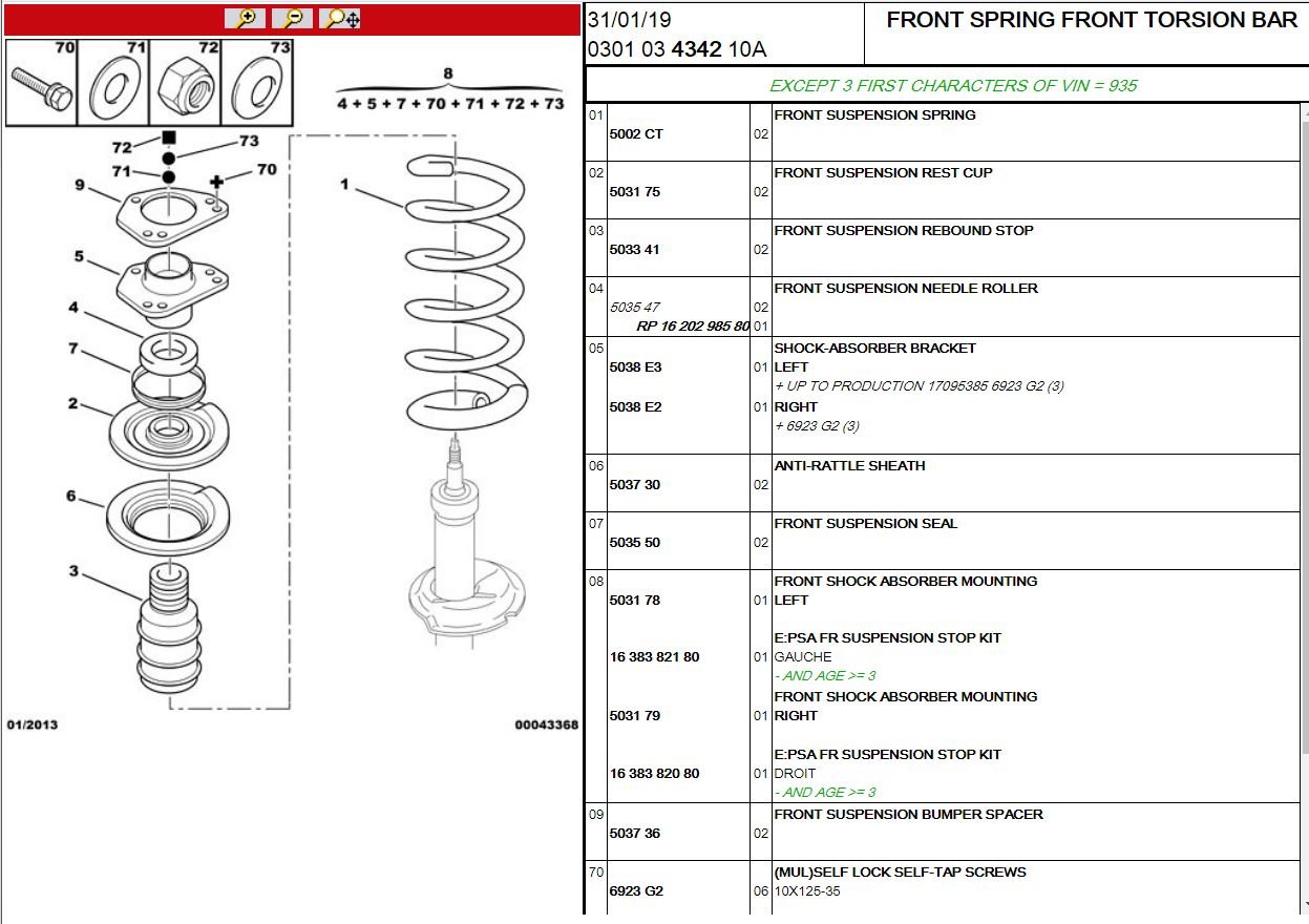

I'm trying to help a local lad out that works for my mate. He's got a Jumper that has a ratchety front right spring and possibly the shock is knackered. The Vin is VF7**************[VIN obfuscated, can be read by forum staff]. I'm after the part numbers relating to both sides please. I see that some susp tops are with or without bearings and some shocks are oil and some gas....and you have to take the lower dash out to access the top mount....nice.
Cheers

Don't know what year it is but if its a mk1 or 2 this sounds a lot worse than it actually is, its only a few screws each side then it just pops off.moizeau wrote: 13 Jun 2020, 16:28 ..and you have to take the lower dash out to access the top mount....nice.

Any help...?
From the VIN:
RELAY II PANELLED VAN - LONG HIGH SIDE STD ROOF TYPE 14 2.2 HDi (DW12UTED) Manual gearbox 5
From the VIN:

Cheers Wheeler and Chris. Have you got the shock numbers please Chris?

Re: Cit Jumper part number request
Thanks Chris
