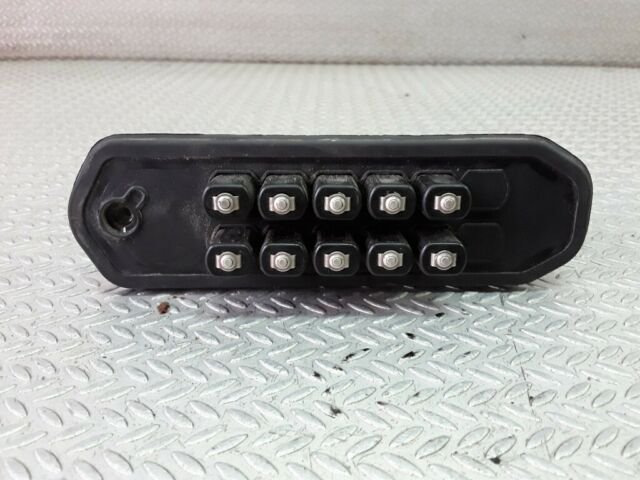

The prime suspect on the C8 for side door problems are the 'Piano' contacts.
Once you get the door open. Once you get the door open give then a good clean on both door & body side. Obviously don't use anything conductive like a wire brush to do this or you could do some electrical damage. I would use some very fine emery paper & some contact cleaner. Also make sure all the 'fingers' spring back out freely when released, lube as necessary.
Do the other side too while you are at it to avoid future problems with that. The doors should re sync once they are fully closed manually again.
