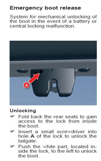

In that case it's probably a break in the wiring as you suspected. I'll probably be inside the bit of the loom that flexes between the tailgate and the body. But first you have to get the tailgate open!
These are the instructions for my C5 X7 but it is almost exactly the same on your car. Once it's open you can start to investigate the wiring loom.

Yes I can get the tailgate open with the emergency release. Presumably removing the interior trim to expose the wiring is fairly straightforward?
